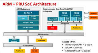

    It seems the main factor that effect the LBBO and SBBO is the ICSS bus.
    From this architecture picture, it seems that PRU access memory locations outside of the PRU subsystem still needs to across the interconnect bus. If so, it also will be influenced by the bus arbitration delay, right?
    Is there any method can order the bus access priority? Such as specifies that PRU0 has the highest priority?

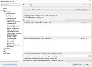

  • I use CCS project to ensure that only ICSSG1 PRU0 runs. And I also modified the project properties with C code compile option --keep_asm be checked.
    But I get the result that LBBO sometimes costs 4 PRU clk when load 4 bytes from PRU0 data memory. This occurs when the LBBO load from a non 4 bytes aligned address in PRU0 data memory. If the address is 4 bytes aligned, LBBO takes 3 PRU clk.

  • Hello xixiguo,
    Good questions!
    Interconnects
    The AM64x Technical Reference Manual (TRM) is not clear on whether PRU/RTU/TX_PRU cores use the internal CBASS interconnect to access the system CBASS0 interconnect, or whether there are two different connection points. My assumption is that there are two separate connection points, since AM64x PRU_ICSSG is very similar to AM65x PRU_ICSSG (for key differences, future readers reference https://www.ti.com/lit/sprac90 ). From the AM65x PRU_ICSSG TRM chapter, we see that the external system CBASS0 connection is separate from the 32-bit internal CBASS interconnect:
    Let me double-check with the designer. I have filed a ticket with the documentation team to add a similar graphic to the AM64x TRM (timeline to fix TBD).

    CBASS Bus structure
    AM64x & AM65x have the same bus structure. Please reference the figure discussed in my previous response.

  • Hi Nick,
    Thanks for reply.
    That means that multiple cores can use the CBASS simultaneously, as long as they are accessing different peripherals or memories.
    Does this mean PRU0 can access Data Memory0 while at the same time PRU1 can access Data Memory1. And PRU0&PRU1 both does not have any arbitration delay?
    If so, how does the CBASS manage this? Does this mean that the CBASS is not a a simple 32bits bus, it also has a control unit to achieve this feature?
    Is there any document to introduce the CBASS working mechanism?
    Best Regards
    xixiguo
  • Hello Xixiguo,
    That is correct. As long as PRU0 and PRU1 are accessing different endpoints (and DMEM0, DMEM1, SMEM are all different endpoints), there is no arbitration delay. Let me know if you would reword anything in https://e2e.ti.com/support/processors-group/processors/f/processors-forum/1096933/faq-pru-how-do-i-calculate-read-and-write-latencies/4065864#4065864 section "Arbitration delay" to make that easier to understand.
    The CBASS bus inside of the PRU subsystem is "fully switched".
    What does that mean? Let's compare the CBASS to a mux: each core (or the access point for a core external to the PRU subsystem) could be thought of as an input, and each endpoint (memory, peripheral, etc) can be thought of as an output. As long as input1 and input2 are being muxed to different outputs, there is absolutely no interference.
    Nick
