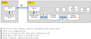

Hello Brijesh,
This picture is my idea,
Is there an existing framework similar to this?
Or, is my idea feasible in TDA4?
SDK:Linux && RTOS 8.0
Hi Zi Wang,
From SDK point of view, you would require remote service framework to send message from mcu2_0 to A72. The rest is all in the application framework on a72, isnt' it? I think then this is possible.

Hello Brijesh,
If this option is feasible, the following steps are required:
1. Porting QT framework on Linux of A72
2. Pass the touch event of MCU2_0 to A72 through remote services and bind it with the QT framework
3. Synchronize the content of the QT display interface to MCU2_0 to display
Regarding the third point, is the synchronization of the interface display achieved through tiovx, and how to connect tiovx with QT?
Is there a ready-made solution for the human-computer interaction of the TDA4 platform?
Hi Zi Wang,
Did not get it. Do you mean to display content of the QT display using OpenVX display node, running on mcu2_0? I am not sure if QT can give output rendered buffer, but it can, then it can be displayed using OpenVX node.

Hi Zi Wang,
Did not get your question. Do you have a way to get the output rendered buffer from QT? If not, we cannot directly send QT buffer to mcu2_0..
The patches are for your another question, where you want to send frames to two DSI displays.. We can merge the frames using overlay manager and then can send merged frame to the display, serializer, which can split the frames and can send output to two displays..
