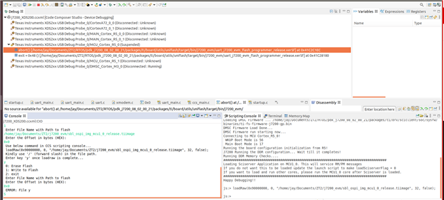

    We try to flash OSPI using CCS on DRA821
    we follow this thread to patch on DRA821 with SDK V8.3,
    (+) [FAQ] How to flash OSPI using CCS on TDA4x/DRA82 EVM? - Processors forum - Processors - TI E2E support forums
    after build and  load uart_j7200_evm_flash_programmer,  we try write to flash , but fail on loadRAW image in scripting console.
    How to fix this issue?
    BR
    Jay

  • Hi Jay:
    In your posted picture, the file path should use the "absolute" path.
    Can you test again by using the abs path? and please use the "forward slash" for being the path.
    THanks.
    BR Rio

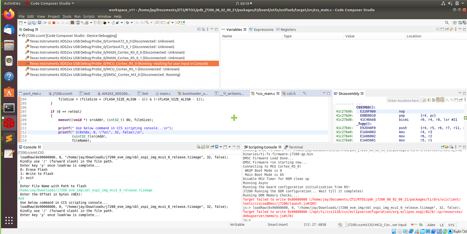

  • Hi RIO
    After happy Debugging, we can loadraw image, after Enter key 'y' once loadraw is complete...
    console show ERROR for nex file write to Flash
    We trt reset CPU and repeat above step for other image(sbl.tiimage/tifi.bin/app.aappimage/nor_spi_patterns.bin), after restart with OSPI mode, show Invalid magic number in Single image header as following
    BR
    JAY

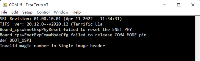

  • Hi Jay,
    I did not get this. Can you please elaborate what did you do here?
    This might be coming from previously flashed images. Try clearing the flash and check.
    Also, have you tried the same method on TI-EVM? Is it working?
