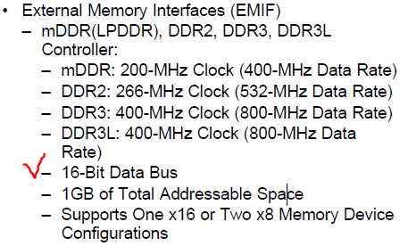

Hi experts
It is 16bit data bus for DDR3 in datasheet of AM335X.
Without knowing the comments, I just made a custom board with just one 8bit databus DDR3 memory (MT41K512M8DA-107).
According to the comments, only 16bit databus DDR3 memory is available? or 8bit available too?
otherwise, should I use two 8bit databus DDR3 memories?
