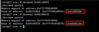

According to the routing PCIE reference clock externally, I set the PCIE clock to the external reference clock.
From the results of the read and write registers, it has been set successfully,
but in /sys/kernel/config/pci_ep/controller,there is no ep device.
