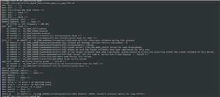

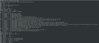

  • Hello, Brijesh
    Here is my modification
    But TIDL still did not run successfully
  • Hi Zi Wang,
    Please set the posX and postY to 0. The error tells that start position + input frame size is greater than output frame size.
    Brijesh

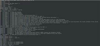

  • Hello, Brijesh
    err log:
    I also tried modifying to width=280 hight=800, but it still does not take effect
    The error message is still "The error tells that start position + input frame size is greater than output frame size. "
