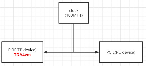

Our design architecture is as follows, we want to use an external clock chip to provide 100MHz clock frequency to PCIE EP and PCIE RC devices at the same time. we use TDA4VM as PCIE EP device in PCIE1 x2 LANE(SERDES1)

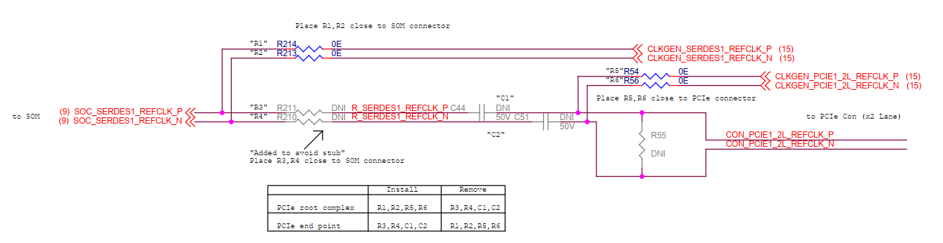

2.Regarding the hardware connection, we directly connect the output pin of the clock chip to the reference clock pin of SERDES1. But on the EVM board, when used as an EP device, resistors and capacitors are added to the external clock and SERDES1 reference clock pins. Is this necessary?

      For question #2,  you must install R3/R4 for external source connection. So you want to know that if  series connection capatitors are necessary?
    It's reqiured by PCIE spec. You can refer to below link for explanation.
    https://electronics.stackexchange.com/questions/285705/why-place-inline-capacitors-on-pcie-traces

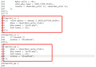

    I test PCIE with two EVM boards in external reference clock. My operation process is as follows:

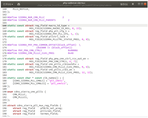

    1、/cfs-file/__key/communityserver-discussions-components-files/791/pcie_2D00_ref_2D00_clock_2D00_out_5F00_sdk8.diff already patch to
    phy-cadence-sierra.c

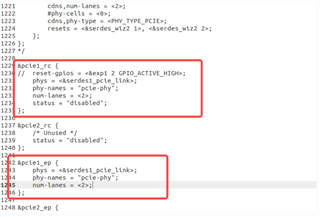

    2、device tree change    k3-j721e-common-proc-board.dts    pcie0、1、2  rc is disable . ep is enable.As shown below
    3、compile kernel and install to sd .

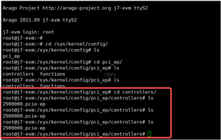

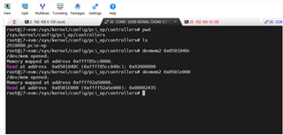

    use devmem2 verify these register ,it set successful。
    but in /sys/kernel/config/pci_ep/controllers only has 2900000.pcie-ep,no 2910000.pcie-ep和2920000.pcie-ep

    In my flow of operations, I did not change the resistors and capacitors on the EVM. As shown in the figure below, in EP mode, you need to remove R1 R2 R5 R6 and add R3 R4 C1 C2

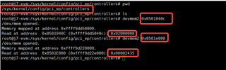

  • I test three case about pcie's internal or external clock :
    case 1: pcie1 in ep model whitout external clock
    I change the device tree  set pcie1 in ep model
    after compile and install,I test  the result is here:
    in /sys/kernel/config/pci_ep/controllers,there is no pcie device
    read register SERDES_RST(0x0501040c) is 0x92000000
    read register PHY_PMA_CMN_CTRL2_PHY_PMA_CMN_CTRL1 is 0x00002435
    case 2:pcie1 in ep model with external clock
    in /sys/kernel/config/pci_ep/controllers,there has pcie device
    case 3:pcie1 in rc mdel
    I change the device tree  set pcie1 in rc model
