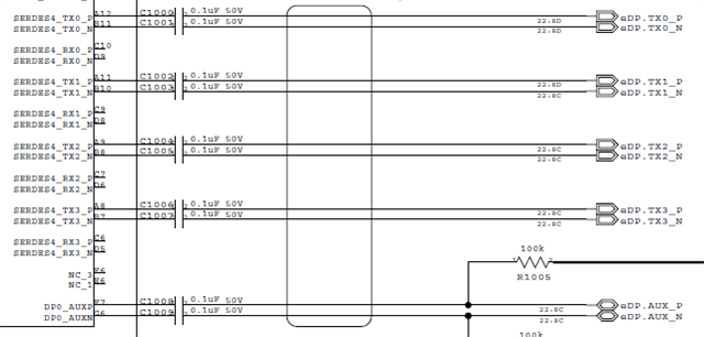

I want to output eDP in vision_apps(mcu2_0)
Below is my modified code:
app_init.c
        prm.timings.width        = 1920U;
        prm.timings.height       = 1080U;
        prm.timings.hFrontPorch  = 0U;
        prm.timings.hBackPorch   = 80U;
        prm.timings.hSyncLen     = 40U;
        prm.timings.vFrontPorch  = 22U;
        prm.timings.vBackPorch   = 10U;
        prm.timings.vSyncLen     = 2U;
        prm.timings.pixelClock   = 136353600ULL;
This is the eDP interface that I'm using

I commented out the appDssConfigureBoard function because my power pin was raised in another way
The output of the eDP in the main domain is connected to a serializer UH983
If there is any output signal from the eDP, it can be detected on the UH983 by reading the register
EDP output is not read on UB983, and there is no screen display
How can I confirm if there is any output from eDP?
  • Hi Zi Wang,
    What is the status of HPD on the board? eDP output will be enabled only on HPD detection. So can you check HPD status?
    Brijesh
  • Hello,Brijesh
    My HPD uses the 'Y4' pin, which is always high 3V
  • Hi Zi Wang,
    ok, can you please check if the API appDctrlDpHpdCbFxn is getting called on R5F/mcu2_0? This is the API, which enables eDP output, so if the HPD is detected and then it should enable eDP output.
    Brijesh
  • Hello,Brijesh
    Yes, this API has been called

    MCU2_0 Log:
    [MCU2_0]     22.884583 s: appDctrlDpHpdCbFxn start
    [MCU2_0]     22.901614 s: src/drv/dctrl/dss_dctrlExtended.c @ Line 371:
    [MCU2_0]     22.901657 s: DP_LinkTraining :Dss_dctrlDrvProcessHpdDp
    [MCU2_0]     22.901690 s: src/drv/dctrl/dss_dctrlExtended.c @ Line 375:
    [MCU2_0]     22.901717 s: trainingResult :DP_LT_OK
    Does this mean that eDP can be output normally?
  • Hi Zi Wang,
    Yes, as shown in the code following, if the link training is successful on HPD detection, it enables the video output.
    if(TRUE == pObj->isConnected)
    if((DP_VIDEO_STATE_REQUESTED == pObj->videoState) ||
    (DP_VIDEO_STATE_RUNNING == pObj->videoState))
    retVal = Dss_dctrlDrvDpStartVideo(pObj);
    Brijesh
  • Hello,Brijesh
    I added log, Dss_dctrlDrvDpStartVideo is called, and the return value is OK
    It seems that serializer is the problem
    Thank you for your help
