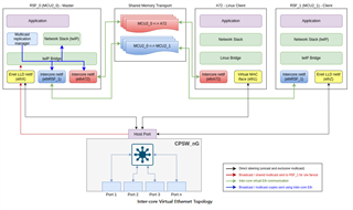

    4.  Ti page describes that Broadcast/Multicast packets are sent to R5F core, and they should be forwared to A72 core through shared memory Transport.
    We want to clarify whether it is needed for forwarding broadcast packets(ARP request packets). Here we are going to use A72 core mainly, so we want to get all traffics coming into A72 core.
    https://software-dl.ti.com/jacinto7/esd/processor-sdk-rtos-j7200/08_02_00_05/exports/docs/ethfw/docs/user_guide/ethfw_c_ug_top.html#ethfw_intercore_topology
    The way broadcast and multicast routing is done is indeed by inter-core communication by shared memory transport. So all the broadcast and multicast frames go through ethfw server.
