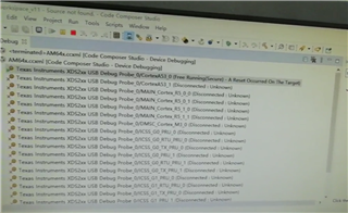

Then I test the function in u-boot,and use TI XDS200 emulator to connect the A53 core within CCS V11.When RESET_REQz HW pin is triggered while bootting from SD CARD,I found the state of A53 core within CCS like figure 1.
Figure 1
When RESET_REQz HW pin is triggered while bootting from eMMC,I found the state of A53 core within CCS like figure 2.
Figure 2
At this time,I can’t test the reset function whether triggered RESET_REQz HW or MCU_PORZ.

    First,I tunned on the hardware booting from SD CARD.When I reseted the hareware by the RESET_REQz HW pin,
    the system reboot and then checked the register providing by your replyed.I found the value of the register like the following picture.
    Second,I tunned on the hardware booting from eMMC.When I reseted by the RESET_REQz HW pin,
    the system did not reboot,I could only get the value of the register by connecting to the core of R5 via CCS,like the following picture.
    At this time ,I could not connected to the core of A53 via CCS.
    What should I do next?

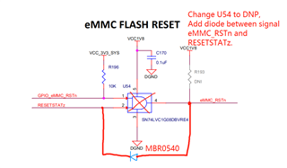

    Here is the hardware designed for reset system,especially for the signal of RESET_REQz.
  • Hello Charles chen,
    Thank you for the schematics. The issues is with the eMMc reset during warm rese.
    Can you please make sure that the eMMC is reset during warm reset. Please refer the anding logic for eMMC reset in the EVM.
    Sreenivasa
  • Hi,Sreenivasa,
    Thanks for your reply.
    I have already checked that the eMMC has reseted during warm reset.
    Here is the hardware designed for eMMC,especially for the connection between RESETSTAT and eMMC.
    Can you help me to check the design?
    Charles
  • Hello Charles,
    Thank you for the inputs. There is a 100K resistors (R121) and the reset is being controlled through the diode. Not sure if the device is seeing a defined reset level.
    Could you please measure the voltage at R121 terminal connected to the memory device during reset.
    Sreenivasa
  • Hi,Sreenivasa,
    The voltage at R121 terminal connected to the eMMC device is 0.14V during warm reset.
  • Hello Charles,
    If i understand correctly, the eMMC interface works during power up and does not work during subsequent warm reset.
    We are anding multiple reset sources in the EVM. With the above schematics, i am not able to understand the logic completely.
    Can you please change the R121 to a lower value (10K ) and test.
    Sreenivasa
  • Hi,Sreenivasa
    Yes,now the eMMC interface works during power up and does not work during subsequent warm reset.
    I have alreaty change the R121 to 10K and test.But it doesn't solve the problem.
    And I also change the design like the following picture.But it doesn't solve the problem.
    Can you have another suggestion for this problem?
    Charles
  • Hi,Sreenivasa
    I also have a test on TMDS64GPEVM board like the following picture.
    I found that the TMDS64GPEVM board can be reboot by push the SW6 button on board.
    I think there is nothing to do with the reset design of eMMC circuit.
    What do you think?
    Charles
