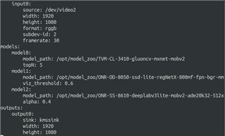

  • Hi Yogesh,
    Can you confirm that running the Edge AI demo application using rpiV2_cam_example.yaml as the configuration file with no changes (meaning 1920x1080 resolution) can be ran?
    Takuma
  • Hello Takuma,
    Thank you for the reply! I fixed the framerate issue by editing the driver for imx219. However, the issue for tiovxisp still persists. I tried running the demo application at 1920x1080 with the plugin and it works fine. But if I change the resolution to any other resolution apart from 1920x1080, the plugin does not produce any output. There is no error, but neither the Demo application nor the Gstreamer Pipeline works.
    Is there any way to solve this issue? I am not sure what is going wrong.

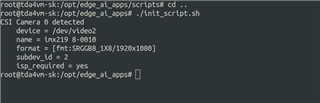

  • Hello Takuma,
           Here is the output for the demo app -
    Final number of subgraphs created are : 1, - Offloaded Nodes - 517, Total Nodes - 517
    APP: Init ... !!!
    MEM: Init ... !!!
    MEM: Initialized DMA HEAP (fd=4) !!!
    MEM: Init ... Done !!!
    IPC: Init ... !!!
    IPC: Init ... Done !!!
    REMOTE_SERVICE: Init ... !!!
    REMOTE_SERVICE: Init ... Done !!!
       313.207144 s: GTC Frequency = 200 MHz
    APP: Init ... Done !!!
       313.210556 s:  VX_ZONE_INIT:Enabled
       313.210783 s:  VX_ZONE_ERROR:Enabled
       313.210853 s:  VX_ZONE_WARNING:Enabled
       313.214001 s:  VX_ZONE_INIT:[tivxInitLocal:130] Initialization Done !!!
       313.216216 s:  VX_ZONE_INIT:[tivxHostInitLocal:86] Initialization Done for HOST !!!
    [GST SRC STR]
    [FLOW 0]
    v4l2src device=/dev/video2 ! queue leaky=2 ! video/x-bayer, width=1920, height=1080, format=rggb ! tiovxisp sink_0::device=/dev/v4l-subdev2 sensor-name=SENSOR_SONY_IMX219_RPI dcc-isp-file=/opt/imaging/imx219/dcc_viss.bin sink_0::dcc-2a-file=/opt/imaging/imx219/dcc_2a.bin format-msb=7 ! video/x-raw, format=NV12 !tiovxmultiscaler name=split_01
    split_01. ! queue ! video/x-raw, width=512, height=512 ! tiovxdlpreproc data-type=3 target=0 channel-order=0 tensor-format=bgr out-pool-size=4 ! application/x-tensor-tiovx ! appsink name=pre_0 max-buffers=2 drop=true
    split_01. ! queue ! video/x-raw, width=1280, height=720 ! tiovxdlcolorconvert target=1 out-pool-size=4 ! video/x-raw, format=RGB ! appsink name=sen_0 max-buffers=2 drop=true
    [GST SINK STR]
    appsrc format=GST_FORMAT_TIME is-live=true block=true do-timestamp=true name=post_0 ! tiovxdlcolorconvert ! video/x-raw,format=NV12, width=1280, height=720 ! queue ! mosaic_0.sink_0
    tiovxmosaic name=mosaic_0 background=/tmp/background_0
    sink_0::startx=320  sink_0::starty=180  sink_0::width=1280   sink_0::height=720
    ! video/x-raw,format=NV12, width=1920, height=1080 ! kmssink sync=false driver-name=tidss

  • Hi Yogesh,
    For testing with the default resolution, can you confirm that changes made to camera initialization script are also update for 1080p? If everything is set up and the error still persists, then it is most likely something wrong with the tuning binaries.
    Could you give me until next Tuesday to consult with ISP expert and recreate issue on my end?
    Takuma
  • Hi Takuma,
    Thank you for the response. I have attached the settings and the logs after I ran the demo application:
    Here are the logs:
