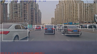

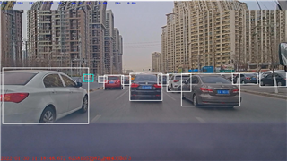

Used SDK8.2
Problem phenomenon:
Using the 8bit method to quantify the yolox model will cause the large target detection position becomes smaller
Experimental record:
I have trained a variety of yolox models, and there will be a similar problem that the large target detection position becomes smaller to varying degrees.
1. Using 16bit quantization can be improved, but the project cannot accept the increase in inference time too much.
2. Using the Troubleshooting Guide for Accuracy/Functional Issues provided by TI to investigate, where is the specific problem that has not been located?
3. Try to use the method suggested by TIDL-RT: Quantization, and the experimental conclusion also shows that the large target detection position becomes smaller. (excluding the use of QAT)
Hope TI can give better suggestions or solutions.
img-8bit:
16bit
We use mixed precision to reduce the quantization accuracy loss for object detection layers.
See an example here: https://github.com/TexasInstruments/edgeai-benchmark/blob/master/configs/detection.py#L314
It is seen that moving the first and last convolution layers to 16bit provides removes most of the accuracy loss. Such layers can be specified using the parameter: 'advanced_options:output_feature_16bit_names_list'
(Here I am referring to our onnxruntime-tidl that offloads supported layers to TIDL - this is what edgeai-benchmark uses). TIDL-RT will have a similar parameter to specify layers to be put in 16bits - you can get the information for TIDL documentation.
Thanks,Manu
I had previously experimented with mixed precision methods at some specific detection layers,I also found this method to improve the problem. Tt increases inference time about 3~4ms, which is unacceptable for our function.
Try putting the first convolution layer and last convolutions layers (last convolution in all branches) - only these to 16 bit. This should not increase the complexity significantly.
