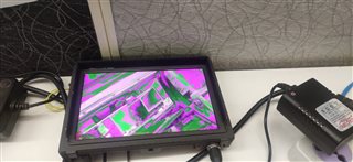

Hi sir,
I am using AM5728 custom board (AM5728->GS2962->LCD lilliput device)
Actually AM5728 board connected to gs2962 serializer to external lcd monitor.
Power on green display occurs.
Using below commands i am sendind video from one board to another board.
output of am5728 is RGB pattern this will give to gs2962(only accept of YCbyCr data)
i am changing am5728 gfx mode to video1 mode its not changing because in video1 mode supports rgb and ycbycr but gfx supports only rgb mode.
BEAGLEBOARD-X15
sudo ifconfig eth0 192.168.31.173 netmask 255.255.254.0 up
HOST=192.168.31.175
gst-launch-1.0 -e v4l2src device=/dev/video1 num-buffers=4000  ! 'video/x-raw, width=1920, height=1080, framerate=30/1, format=YUY2' ! vpe num-input-buffers=8 ! queue ! ducatih264enc intra-interval=1 ! h264parse ! rtph264pay ! udpsink port=5000 host=$HOST
CUSTOM-BOARD
sudo ifconfig eth0 192.168.31.175 netmask 255.255.254.0 up
gst-launch-1.0 -v udpsrc port=5000 ! "application/x-rtp, media=(string)video, clock-rate=(int)90000, encoding-name=(string)H264, payload=(int)96" ! rtph264depay ! h264parse ! decodebin ! videoconvert ! kmssink
Below image it's displaying:
    I think your display device is expecting YUV as input format (probably over discrete sync interface), but DSS does not support it. DSS outputs RGB format over discrete sync interface.
    This does not look like related to input GRPX or video pipeline..
    Brijesh

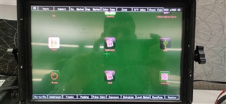

  • Hi sir,
    we are using discrete sync only.
    Because our gs2972 device which supports both embedded sync and discrete sync. we can use embedded sync but some limitation in errata for hsync timings not more than 255. because of that we used discrete sync.
    internally RGB to YUV any convertion will happens.
    Thanking you,
    Ramachandra
  • I think you can configure DSS to output in 8bit or 16bit embedded YUV422 format. But please check if SW supports it. Also what is the size of hsync that the receiving device expects? Because DSS cannot generate more than 256 clock cycle of hsync.
    Brijesh

  • But please note that DSS does not support YUV output on discrete sync interface. This could be reason why you are seeing greenish image. LDC is expecting the YUV422 image, but the output from DSS is in RGB format..
    Brijesh

    Actually required output is YUV format, In embedded sync support both RGB & YUV formats are available,
    Not really, embedded sync output supports YUV format and discrete sync supports RGB formats.
    1. We will change to embedded sync and with below configuration any problem will give sir(because hsw <256 bytes) ,
    Looks fine to me. Please note that if output interface is 8bit, 148 will be multiplied by 2 in the driver, so it becomes 296, but max hsync-len is only 256 clock cycle, so it would be limited to 256 clock cycles.
    2. we enabled rgb to yuv
    RGB 2 YUV cannot be enabled for discrete sync interface.
    Brijesh
