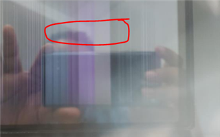

4.login arago terminal,check /sys/class/drm/card0-LVDS-1/ exist, register sucessful see attachment boot log

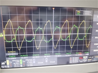

5.check OLDI interface output by digital oscilloscope , and do not have signal
do i miss something? how to enable oldi interface ,
