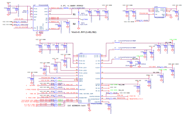

Hi Expert,
customer board can not boot.
AM62XX_PinB10_JTAG_nTRST -> High
TPS6521903RHBR_PMIC_PGOOD -> High
TPS6521903RHBR_PMIC_STBY -> High
AM62XX_PinF22_RESETSTATz -> High
AM62XX_PinE21_PORTz_OUT -> High
AM62XX_PinF20_RESET_REQZ->High
AM62XX_PinD16_EXTINTn -> High
AM62XX_PinD2_MCU_PORZ -> High
AM62XX_PinE11_MCU_RESETZ -> High
AM62XX_PinB12_MCU_RESETSTATZ -> High
AM62XX_PinD1_MCU_ERRORN -> High
DDR_RESET# -> Low
Y1_32.768KHZ -> No Output
SD_CARD_MMC1_CLK -> No Output
 Could I check any pin before CPU read boot mode?
