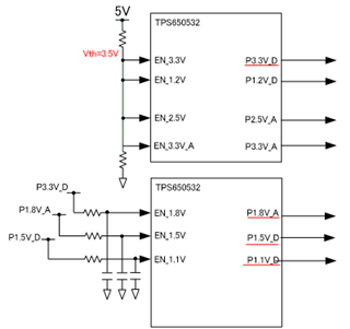

I have a question from one of our clients.
They are designing a custom board using AM4372, but have a question on Power-Down Sequencing.
In the dataSheet "5.12.1.3 Power-Down Sequencing" there is a description of 4 sequences.
The second one "If it is desired to ramp down VDDS, VDDS_CLKOUT and VDDSHVx [x=1-11] simultaneously,..." and the last one "When using simplified power-down sequence,...".
The simplified power-down sequence says that there is no order of down between each power supply. I understand from past questions and answers that this is simultaneous power-down.
However, I think this is the same in the second sequence, but here there is a condition attached. What is the difference?
If PWRONRSTn is asserted, is it OK to power down in the simplified sequence?
