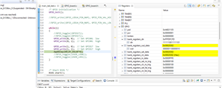

  • Hi Brad,
    I have included your code changes and It is working fine for me. I am verifying the GPIO from "bank_register_out_data" from the register view.

  • Ranjett,
    With the code you presented, I agree with your results.  The bank_register_out_data register values change.  However, the physical pin does not follow the bank_register_out_data register values.
    I found that the Pin Control 0 (PIN_CONTROL_0) Register needs to have the pin configured for GPIO operation for the GPIO system to control the upper pins, ie. GPIO 16 to 31.  After setting this register the bank_register_out_data register can control the state of the upper GPIO pins.

  • Hi Brad,
    I will modify the Register and probe GPIO hardware responses in my C6657 EVM.
    To modify "PIN_CONTROL_0" you can directly write to the Register address. Please follow the link,
    https://e2e.ti.com/support/processors-group/processors/f/processors-forum/1113523/tms320c6657-how-to-access-gpio-pins-through-the-registers-for-tms320c6657
    1. Is there a different driver that configures the pin mux registers or has it been left for the programmer to properly configure the pin mux registers?
    There is SYS/BIOS and CSL APIs which were the methods to access the peripherals. We can also use the direct above method to write to the particular address.
