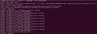

I am trying to use IMX390 from oToBrite on Linux but there are some errors in the system log.
The cause is probably from the absence of IMX390 sensor on the I2C bus.
I am wondering is there a better way to fix this issue like skipping communication between IMX390 and driver?
ub953 is at 0x18 and ISP is at 0x6C.
Michael

    I think there are few things need to be modified:
    1. Modify driver ti,ds90ub960-q1 with fixed frame desc so that it does need to qurry sensor anymore.
    2. Change input format from RAW to UYVY
    Here is the dts file I modified:

  • Hi Michael,
    Modify driver ti,ds90ub960-q1 with fixed frame desc so that it does "NOT" need to qurry sensor anymore.
    2. Change input format from RAW to UYVY.
    With these changes, could you please brief me the current status of your issue?
    Few questions from my end to get more clarity on your usecase:
    1. Have you written an ISP driver to where a streamON command could be sent from the user-space to start the IMX390 sensor?
    2. Have you set the format for UB953 and UB960 using the ./media-ctl -V command?
    3. Have you set the routes using the ./media-ctl -R command?
    4. Could you please share the current logs for the command ./media-ctl -p?
    5. What is the streaming command you are using? Could you please share the logs after sending the streaming command?
    Nikhil
  • Hi Nikhil,
    The camera module does noe need streamON command. It sends out image data once the power is on.
    I am not able to set the format for UB953 and UB960 successfully. It gives invalid argumnet error.
    I try to link them but it also gives invalid argument error.
    Something is wrong that video devices do not show up.
    Michael
  • Hi Michael,
    Here the syntax is wrong. You shouldn't include @1/30 here.
    Please refer below format (Please change the name and format accordingly)
    media-ctl -V '"ds90ub953 9-0044":0 [fmt:SRGGB12_1X12/1936x1100 field: none]'
    Could you try to set the route here instead.
    ./media-ctl -R '"4500000.ticsi2rx" [0/0 -> 1/0 [1]]'
    yes, here the video devices did not show up and also the connection between the bridge to csi2rx is missing.
    Could you share the full linux kernel logs in order to check if some probe error occured?
    Nikhil
  • Hi Nikhil,
    I used the command accordingly, but it still gave some error.
    ./media-ctl --set-v4l2 '"ds90ub953 9-0044":0 [fmt:UYVY8_2X8/1920x1080 field: none]'
    --> Unable to setup fornats: No such file or directory (2)
    --> VIDIOC_SUBDEV_S_ROUTING failed: -2
         unable to setup routes: No such file or directory (2)

    [    7.478600] systemd[1]: Mounting POSIX Message Queue File System...
    [    7.502533] systemd[1]: Mounting Kernel Debug File System...
    [    7.528808] systemd[1]: Mounting Temporary Directory (/tmp)...
    [    7.546724] systemd[1]: Starting Create list of static device nodes for the current kernel...
    [    7.574458] systemd[1]: Starting Start psplash boot splash screen...
    [    7.599586] systemd[1]: Starting RPC Bind...
    [    7.612626] systemd[1]: Condition check resulted in File System Check on Root Device being skipped.
    [    7.624327] systemd[1]: Starting Journal Service...
    [    7.652524] systemd[1]: Starting Load Kernel Modules...
    [    7.670767] systemd[1]: Starting Remount Root and Kernel File Systems...
    [    7.671190] cryptodev: loading out-of-tree module taints kernel.
    [    7.685901] cryptodev: driver 1.10 loaded.
    [    7.705276] EXT4-fs (mmcblk1p2): re-mounted. Opts: (null)
    [    7.706709] systemd[1]: Starting udev Coldplug all Devices...
    [    7.731262] systemd[1]: Started RPC Bind.
    [    7.748819] systemd[1]: Started Journal Service.
    [    7.970638] systemd-journald[170]: Received client request to flush runtime journal.
    [    8.076956] urandom_read_iter: 47 callbacks suppressed
    [    8.076960] random: systemd: uninitialized urandom read (16 bytes read)
    [    8.104550] random: systemd: uninitialized urandom read (16 bytes read)
    [    8.116653] random: systemd-journal: uninitialized urandom read (16 bytes read)
    [    8.548892] CAN device driver interface
    [    8.785878] ina2xx 5-0040: power monitor ina226 (Rshunt = 10000 uOhm)
    [    8.827136] ina2xx 5-0041: power monitor ina226 (Rshunt = 10000 uOhm)
    [    8.917091] ina2xx 5-0042: power monitor ina226 (Rshunt = 10000 uOhm)
    [    8.934258] ina2xx 5-0043: power monitor ina226 (Rshunt = 10000 uOhm)
    [    8.951200] ds90ub960 9-0036: Successfully probed (rev/mask 40)
    [    8.951294] ina2xx 5-0044: power monitor ina226 (Rshunt = 10000 uOhm)
    [    8.971439] i2c i2c-10: of_i2c: modalias failure on /bus@100000/i2c@2060000/deser@3d/i2c-atr/i2c@0/sensor@1a
    [    9.008444] i2c i2c-10: Failed to create I2C device for /bus@100000/i2c@2060000/deser@3d/i2c-atr/i2c@0/sensor@1a
    [    9.024803] ina2xx 5-0045: power monitor ina226 (Rshunt = 5000 uOhm)
    [    9.053204] ina2xx 5-0046: power monitor ina226 (Rshunt = 10000 uOhm)
    [    9.070099] ina2xx 5-0047: power monitor ina226 (Rshunt = 10000 uOhm)
    [    9.098077] ina2xx 5-0048: power monitor ina226 (Rshunt = 10000 uOhm)
    [    9.114098] ina2xx 5-0049: power monitor ina226 (Rshunt = 10000 uOhm)
    [    9.127085] ds90ub960 9-003d: Successfully probed (rev/mask 40)
    [    9.147926] ina2xx 5-004a: power monitor ina226 (Rshunt = 10000 uOhm)
    [    9.182414] ina2xx 5-004b: power monitor ina226 (Rshunt = 10000 uOhm)
    [    9.198798] ina2xx 5-004c: power monitor ina226 (Rshunt = 10000 uOhm)
    [    9.207906] img_enc 4200000.video-encoder: vxe_enc_probe: using heap 1 for internal alloc
    [    9.228332] img_enc 4200000.video-encoder: encoder registered as /dev/video0
    [    9.239140] ina2xx 5-004d: power monitor ina226 (Rshunt = 10000 uOhm)
    [    9.280555] ina2xx 5-004e: power monitor ina226 (Rshunt = 10000 uOhm)
    [    9.307112] ina2xx 5-004f: power monitor ina226 (Rshunt = 10000 uOhm)
    [    9.328032] img_dec 4300000.video-decoder: decoder registered as /dev/video1
    [    9.643575] k3-dsp-rproc 4d80800000.dsp: assigned reserved memory node c66-dma-memory@a7000000
    [    9.704108] [drm] Initialized tidss 1.0.0 20180215 for 4a00000.dss on minor 0
    [    9.714189] tidss 4a00000.dss: [drm] Cannot find any crtc or sizes
    [    9.748525] pvrsrvkm 4e20000000.gpu: More than one power domain for this GPU, gpu driver manages power domains
    [    9.772728] k3-dsp-rproc 4d80800000.dsp: configured DSP for remoteproc mode
    [    9.821024] platform 41000000.r5f: R5F core may have been powered on by a different host, programmed state (0) != actual state (1)
    [   10.064317] PVR_K:  201: Read BVNC 22.104.208.318 from HW device registers
    [   10.080399] random: crng init done
    [   10.083819] random: 25 urandom warning(s) missed due to ratelimiting
    [   10.092196] k3-dsp-rproc 4d80800000.dsp: local reset is deasserted for device
    [   10.099399] PVR_K:  201: RGX Device registered with BVNC 22.104.208.318
    [   10.106455] remoteproc remoteproc0: 4d80800000.dsp is available
    [   10.115519] [drm] Initialized pvr 1.15.6133109 20170530 for 4e20000000.gpu on minor 1
    [   10.133562] k3-dsp-rproc 4d81800000.dsp: assigned reserved memory node c66-dma-memory@a6000000
    [   10.148573] remoteproc remoteproc0: powering up 4d80800000.dsp
    [   10.155030] remoteproc remoteproc0: Booting fw image j7-c66_0-fw, size 144540
    [   10.169013] k3-dsp-rproc 4d80800000.dsp: booting DSP core using boot addr = 0xa6200400
    [   10.181609] k3-dsp-rproc 4d81800000.dsp: configured DSP for remoteproc mode
    [   10.189014] platform 41000000.r5f: configured R5F for IPC-only mode
    [   10.195336]  remoteproc0#vdev0buffer: assigned reserved memory node c66-dma-memory@a7000000
    [   10.204960] k3-dsp-rproc 4d81800000.dsp: local reset is deasserted for device
    [   10.207533] virtio_rpmsg_bus virtio0: rpmsg host is online
    [   10.212297] platform 41000000.r5f: assigned reserved memory node r5f-dma-memory@a0000000
    [   10.224449]  remoteproc0#vdev0buffer: registered virtio0 (type 7)
    [   10.232033] remoteproc remoteproc2: 4d81800000.dsp is available
    [   10.233107] remoteproc remoteproc1: 41000000.r5f is available
    [   10.237979] remoteproc remoteproc0: remote processor 4d80800000.dsp is now up
    [   10.243726] remoteproc remoteproc1: attaching to 41000000.r5f
    [   10.260511] virtio_rpmsg_bus virtio0: creating channel ti.ipc4.ping-pong addr 0xd
    [   10.268553] platform 41000000.r5f: R5F core initialized in IPC-only mode
    [   10.270104] k3-dsp-rproc 64800000.dsp: assigned reserved memory node c71-dma-memory@a8000000
    [   10.283791] virtio_rpmsg_bus virtio0: creating channel rpmsg_chrdev addr 0xe
    [   10.297692] remoteproc remoteproc2: powering up 4d81800000.dsp
    [   10.303542] remoteproc remoteproc2: Booting fw image j7-c66_1-fw, size 144540
    [   10.316793] k3-dsp-rproc 4d81800000.dsp: booting DSP core using boot addr = 0xa7200400
    [   10.328723]  remoteproc2#vdev0buffer: assigned reserved memory node c66-dma-memory@a6000000
    [   10.337773]  remoteproc1#vdev0buffer: assigned reserved memory node r5f-dma-memory@a0000000
    [   10.339226] virtio_rpmsg_bus virtio1: rpmsg host is online
    [   10.354993]  remoteproc2#vdev0buffer: registered virtio1 (type 7)
    [   10.363715] remoteproc remoteproc2: remote processor 4d81800000.dsp is now up
    [   10.370948] virtio_rpmsg_bus virtio1: creating channel ti.ipc4.ping-pong addr 0xd
    [   10.382642] virtio_rpmsg_bus virtio1: creating channel rpmsg_chrdev addr 0xe
    [   10.418402] virtio_rpmsg_bus virtio2: rpmsg host is online
    [   10.425082] k3-dsp-rproc 64800000.dsp: configured DSP for remoteproc mode
    [   10.431973] virtio_rpmsg_bus virtio2: creating channel ti.ipc4.ping-pong addr 0xd
    [   10.440197]  remoteproc1#vdev0buffer: registered virtio2 (type 7)
    [   10.442018] remoteproc remoteproc3: 64800000.dsp is available
    [   10.491196] remoteproc remoteproc1: remote processor 41000000.r5f is now attached
    [   10.580728] platform 5c00000.r5f: configured R5F for remoteproc mode
    [   10.608129] platform 5c00000.r5f: assigned reserved memory node r5f-dma-memory@a2000000
    [   10.622957] remoteproc remoteproc4: 5c00000.r5f is available
    [   10.639690] platform 5d00000.r5f: configured R5F for remoteproc mode
    [   10.716065] remoteproc remoteproc4: powering up 5c00000.r5f
    [   10.721871] remoteproc remoteproc4: Booting fw image j7-main-r5f0_0-fw, size 626036
    [   10.729836] remoteproc remoteproc3: powering up 64800000.dsp
    [   10.735712] remoteproc remoteproc3: Booting fw image j7-c71_0-fw, size 10489000
    [   10.743764] platform 5d00000.r5f: assigned reserved memory node r5f-dma-memory@a3000000
    [   10.748438] remoteproc remoteproc3: unsupported resource 65538
    [   10.759654]  remoteproc4#vdev0buffer: assigned reserved memory node r5f-dma-memory@a2000000
    [   10.771686] k3-dsp-rproc 64800000.dsp: booting DSP core using boot addr = 0xa8e00000
    [   10.780337] virtio_rpmsg_bus virtio3: rpmsg host is online
    [   10.786131]  remoteproc4#vdev0buffer: registered virtio3 (type 7)
    [   10.790072] remoteproc remoteproc5: 5d00000.r5f is available
    [   10.792578] remoteproc remoteproc4: remote processor 5c00000.r5f is now up
    [   10.805274]  remoteproc3#vdev0buffer: assigned reserved memory node c71-dma-memory@a8000000
    [   10.816258] virtio_rpmsg_bus virtio4: rpmsg host is online
    [   10.824060]  remoteproc3#vdev0buffer: registered virtio4 (type 7)
    [   10.831479] remoteproc remoteproc3: remote processor 64800000.dsp is now up
    [   10.841271] virtio_rpmsg_bus virtio4: creating channel ti.ipc4.ping-pong addr 0xd
    [   10.849276] virtio_rpmsg_bus virtio4: creating channel rpmsg_chrdev addr 0xe
    [   10.871089] remoteproc remoteproc5: powering up 5d00000.r5f
    [   10.876719] remoteproc remoteproc5: Booting fw image j7-main-r5f0_1-fw, size 98444
    [   10.890362] platform 5e00000.r5f: configured R5F for remoteproc mode
    [   10.891371]  remoteproc5#vdev0buffer: assigned reserved memory node r5f-dma-memory@a3000000
    [   10.907683] virtio_rpmsg_bus virtio5: rpmsg host is online
    [   10.913255]  remoteproc5#vdev0buffer: registered virtio5 (type 7)
    [   10.919367] remoteproc remoteproc5: remote processor 5d00000.r5f is now up
    [   10.926682] virtio_rpmsg_bus virtio5: creating channel ti.ipc4.ping-pong addr 0xd
    [   10.939228] platform 5e00000.r5f: assigned reserved memory node r5f-dma-memory@a4000000
    [   10.949203] remoteproc remoteproc6: 5e00000.r5f is available
    [   10.960086] remoteproc remoteproc6: powering up 5e00000.r5f
    [   10.965741] remoteproc remoteproc6: Booting fw image j7-main-r5f1_0-fw, size 98444
    [   10.993394] platform 5f00000.r5f: configured R5F for remoteproc mode
    [   10.994640]  remoteproc6#vdev0buffer: assigned reserved memory node r5f-dma-memory@a4000000
    [   11.013096] virtio_rpmsg_bus virtio6: rpmsg host is online
    [   11.018684]  remoteproc6#vdev0buffer: registered virtio6 (type 7)
    [   11.024800] remoteproc remoteproc6: remote processor 5e00000.r5f is now up
    [   11.032160] virtio_rpmsg_bus virtio6: creating channel ti.ipc4.ping-pong addr 0xd
    [   11.045057] virtio_rpmsg_bus virtio5: creating channel rpmsg_chrdev addr 0xe
    [   11.052873] virtio_rpmsg_bus virtio6: creating channel rpmsg_chrdev addr 0xe
    [   11.060317] virtio_rpmsg_bus virtio2: creating channel rpmsg_chrdev addr 0xe
    [   11.067851] platform 5f00000.r5f: assigned reserved memory node r5f-dma-memory@a5000000
    [   11.154134] m_can_platform 40528000.can: m_can device registered (irq=23, version=32)
    [   11.166146] remoteproc remoteproc7: 5f00000.r5f is available
    [   11.166221] m_can_platform 40568000.can: m_can device registered (irq=25, version=32)
    [   11.187589] m_can_platform 2701000.can: m_can device registered (irq=55, version=32)
    [   11.199909] m_can_platform 2721000.can: m_can device registered (irq=57, version=32)
    [   11.300257] remoteproc remoteproc7: powering up 5f00000.r5f
    [   11.305838] remoteproc remoteproc7: Booting fw image j7-main-r5f1_1-fw, size 98444
    [   11.319069]  remoteproc7#vdev0buffer: assigned reserved memory node r5f-dma-memory@a5000000
    [   11.327932] virtio_rpmsg_bus virtio7: rpmsg host is online
    [   11.336477]  remoteproc7#vdev0buffer: registered virtio7 (type 7)
    [   11.342637] remoteproc remoteproc7: remote processor 5f00000.r5f is now up
    [   11.356439] virtio_rpmsg_bus virtio7: creating channel ti.ipc4.ping-pong addr 0xd
    [   11.364067] virtio_rpmsg_bus virtio7: creating channel rpmsg_chrdev addr 0xe
    [   12.076068] virtio_rpmsg_bus virtio3: creating channel ti.ethfw.notifyservice addr 0x1e
    [   12.134954] virtio_rpmsg_bus virtio3: creating channel rpmsg-kdrv addr 0x1a
    [   12.144978] rpmsg-kdrv-eth-switch rpmsg-kdrv-1-mpu_1_0_ethswitch-device-0: Device info: permissions: 3FFFFFFF uart_id: 2
    [   12.156852] rpmsg-kdrv-eth-switch rpmsg-kdrv-1-mpu_1_0_ethswitch-device-0: FW ver 0.2 (rev 0)  2/Feb/2022 SHA:bd5a13f4
    [   12.167868] rpmsg-kdrv-eth-switch rpmsg-kdrv-3-mpu_1_0_ethmac-device-1: Device info: permissions: 3FFFFFFF uart_id: 2
    [   12.179399] rpmsg-kdrv-eth-switch rpmsg-kdrv-3-mpu_1_0_ethmac-device-1: FW ver 0.2 (rev 0)  2/Feb/2022 SHA:bd5a13f4
    [   12.192695] ds90ub953 9-0044: Found rev 2, mask 0
    [   12.219023] usbcore: registered new interface driver usbfs
    [   12.228110] usbcore: registered new interface driver hub
    [   12.234658] usbcore: registered new device driver usb
    [   12.253545] remoteproc remoteproc8: b034000.pru is available
    [   12.274530] remoteproc remoteproc9: b004000.rtu is available
    [   12.281365] cdns-csi2rx 4504000.csi-bridge: Probed CSI2RX with 4/4 lanes, 4 streams, external D-PHY
    [   12.281543] remoteproc remoteproc10: b00a000.txpru is available
    [   12.300192] remoteproc remoteproc11: b038000.pru is available
    [   12.306027] j721e-cpsw-virt-mac main_r5fss_cpsw9g_virt_mac0: rpmsg attach_ext - rx_mtu:1522 features:0000000B tx_mtu[0]:2024 flow_idx:172 tx_cpsw_psil_dst_id:51712 mac_addr:70:ff:76:1d:92:c1 mac-only:0
    [   12.324413] remoteproc remoteproc12: b006000.rtu is available
    [   12.330716] remoteproc remoteproc13: b00c000.txpru is available
    [   12.339943] remoteproc remoteproc14: b134000.pru is available
    [   12.345976] remoteproc remoteproc15: b104000.rtu is available
    [   12.352130] remoteproc remoteproc16: b10a000.txpru is available
    [   12.358828] remoteproc remoteproc17: b138000.pru is available
    [   12.364917] j721e-cpsw-virt-mac main_r5fss_cpsw9g_virt_mac0: virt_cpsw_nuss mac loaded
    [   12.374895] j721e-cpsw-virt-mac main_r5fss_cpsw9g_virt_mac0: rdev_features:0000000B rdev_mtu:1522 flow_id:172 tx_psil_dst_id:4A00 mac_only:0
    [   12.387791] remoteproc remoteproc18: b106000.rtu is available
    [   12.393561] j721e-cpsw-virt-mac main_r5fss_cpsw9g_virt_mac0: local_mac_addr:00:00:00:00:00:00 rdev_mac_addr:70:ff:76:1d:92:c1
    [   12.407742] remoteproc remoteproc19: b10c000.txpru is available

    Michael
  • Hi Michael,
    Thank you for providing the logs.
    I did a review of your linux logs and didn't find any specific error that could cause this.
    Could you share the logs of media-ctl -p? (Not the image). Here we could get more information from the logs.
    Also, is it possible for you to put logs in the linux driver and check? If yes, could you put few logs in the function ti_csi2rx_probe() in the file ${PSDKLA}/board_support/linux-xx/drivers/media/platform/ti/j721e-csi2rx/j721e-csi2rx.c and check whether this function fails? (i.e., checking its return value at each stage)
    Nikhil
  • Hi Nikhil:
    Now, the Customer - Michael confirmed:
    Since the TI native code will bring up the ISP driver, but, this is not what he needs.
    May you help to let him know about : How to NOT use the Native ISP camera driver?
    Thanks.
    BR Rio
  • Hi Rio,
    I don't think we have a Native ISP driver on the Linux side.
    Could you please get the above information? This could tell us more about the issue.
    Nikhil

  • Hi Nikhil:
    Any feedback of this ticket?
    BR Rio
  • Hi Michael,
    Sorry for the delay in response.
    We were trying to simulate this scenario at our end by not connecting the camera and doing your dts changes.
    We were able to see that the context/video devices did not show up.
    After further debugging, we saw that the UB953 serializer driver waits for a notification from the sensor in order to propogate further.
    Hence, we included a dummy IMX390 driver which only notifies to the serializer. Please find the patch below for the same.
    /cfs-file/__key/communityserver-discussions-components-files/791/0001_2D00_media_2D00_i2c_2D00_imx390_2D00_dummy_2D00_test_2D00_driver.patch
    Further you could make changes in your dts file by referring the below changes
    diff --git a/arch/arm64/boot/dts/ti/k3-j721e-fpdlink-imx390-cm-0-0.dts b/arch/arm64/boot/dts/ti/k3-j721e-fpdlink-imx390-cm-0-0.dts
    index fff3678ab505..8ad93ff2affd 100644
    --- a/arch/arm64/boot/dts/ti/k3-j721e-fpdlink-imx390-cm-0-0.dts
    +++ b/arch/arm64/boot/dts/ti/k3-j721e-fpdlink-imx390-cm-0-0.dts
    @@ -78,17 +78,9 @@
                    #size-cells = <0>;
                    sensor@21 {
    -                       compatible = "sony,imx390";
    +                       compatible = "ottobrite,imx390dummy";
                            reg = <0x21>;
    -                       clocks = <&clk_cam_27M>;
    -                       clock-names = "inck";
    -                       xclr-gpios = <&serializer 0 GPIO_ACTIVE_LOW>;
    -                       error0-gpios = <&serializer 1 GPIO_ACTIVE_HIGH>;
    -                       error1-gpios = <&serializer 2 GPIO_ACTIVE_HIGH>;
    -                       comready-gpios = <&serializer 3 GPIO_ACTIVE_HIGH>;
                            port {
                                    sensor_out: endpoint {
                                            remote-endpoint = <&ub953_in>;
    Please try out these changes at your end and let me know if this resolves your issue.
    Nikhil
  • Hi Nikhil,
    Thank you so much for giving us great help.
    There is some minor problem got to be resolved.
    1. The log of "media-ctl -p" seems fine.
      Media controller API version 5.10.120
      Media device information
      driver          j721e-csi2rx
      model           TI-CSI2RX
      serial
      bus info        platform:4500000.ticsi2rx
      hw revision     0x1
      driver version  5.10.120
      Device topology
      - entity 1: 4500000.ticsi2rx (17 pads, 17 links, 1 route)
                  type V4L2 subdev subtype Unknown flags 0
                  device node name /dev/v4l-subdev0
      	routes:
      		0/0 -> 1/0 [ACTIVE]
      	pad0: Sink
      		<- "cdns_csi2rx.4504000.csi-bridge":1 [ENABLED,IMMUTABLE]
      	pad1: Source
      		-> "4500000.ticsi2rx context 0":0 [ENABLED,IMMUTABLE]
      	pad2: Source
      		-> "4500000.ticsi2rx context 1":0 [ENABLED,IMMUTABLE]

    2. It gives broke pipe error after requesting it to start capturing.
      root@j7-evm:~# yavta -c -Fcapture -s 1920x1080 -f UYVY /dev/video3
      Device /dev/video3 opened.
      Device `j721e-csi2rx' on `platform:4500000.ticsi2rx' is a video output (without mplanes) device.
      Video format set: UYVY (59565955) 1920x1080 (stride 3840) field none buffer size 4147200
      Video format: UYVY (59565955) 1920x1080 (stride 3840) field none buffer size 4147200
      8 buffers requested.
      length: 4147200 offset: 0 timestamp type/source: mono/EoF
      Buffer 0/0 mapped at address 0xffff843b4000.
      length: 4147200 offset: 4149248 timestamp type/source: mono/EoF
      Buffer 1/0 mapped at address 0xffff83fbf000.
      length: 4147200 offset: 8298496 timestamp type/source: mono/EoF
      Buffer 2/0 mapped at address 0xffff83bca000.
      length: 4147200 offset: 12447744 timestamp type/source: mono/EoF
      Buffer 3/0 mapped at address 0xffff837d5000.
      length: 4147200 offset: 16596992 timestamp type/source: mono/EoF
      Buffer 4/0 mapped at address 0xffff833e0000.
      length: 4147200 offset: 20746240 timestamp type/source: mono/EoF
      Buffer 5/0 mapped at address 0xffff82feb000.
      length: 4147200 offset: 24895488 timestamp type/source: mono/EoF
      Buffer 6/0 mapped at address 0xffff82bf6000.
      length: 4147200 offset: 29044736 timestamp type/source: mono/EoF
      Buffer 7/0 mapped at address 0xffff82801000.
      Unable to start streaming: Broken pipe (32).
      8 buffers released.
    Michael
  • Hi Michael,
    2 things I noticed here
    1. The context is mapped to /dev/video2 and you are trying to stream video3 in the yavta command.
        Could you try to stream in /dev/video2?
    2. The format of the imx390dummy 10-0021 is YUYV8_2X8 whereas others are in UYVY8_2X8. This mostly shouldn't be an issue, but can you set the same format in the dummy driver too if the issue doesn't resolve with the first step.
    Nikhil
  • Appreciate for your great work, Nikhil.
    It works like a charm.
