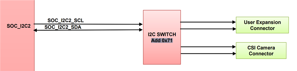

  • Hello Naresh,
    1. Not showing camera module address (0x3c) and switch address (0x71 )  in i2c detect command.  [ may i know what is the use of switch (address :0x71 , is it mandatory to configure in dts ? ]
    This I2C switch is used to communicate with the CSI camera connector. Please refer to the AM62x SK-EVM Schematics. The I2C Tree shows this connection:
    You can verify the I2C topology by the following commands:
    root@am62xx-evm:/sys/bus/i2c/devices# ls
    0-003f  1-001b  1-0022  1-003b  2-0071  4-0060  i2c-0  i2c-1  i2c-2  i2c-3  i2c-4  i2c-5
    root@am62xx-evm:/sys/bus/i2c/devices# readlink 2-0071
    ../../../devices/platform/bus@f0000/20020000.i2c/i2c-2/2-0071
    root@am62xx-evm:/sys/bus/i2c/devices# ls ../../../devices/platform/bus@f0000/20020000.i2c/i2c-2/2-0071/ -al
    total 0
    drwxr-xr-x 3 root root    0 Sep 27 17:03 .
    drwxr-xr-x 7 root root    0 Sep 27 17:03 ..
    lrwxrwxrwx 1 root root    0 Nov  2 18:10 channel-0 -> ../i2c-3
    lrwxrwxrwx 1 root root    0 Nov  2 18:10 channel-1 -> ../i2c-4
    lrwxrwxrwx 1 root root    0 Nov  2 18:10 driver -> ../../../../../../bus/i2c/drivers/pca954x
    2. getting only one line dmesg logs regd. camera as
    Can you do a "dmesg | grep ov5647" and share the output?
    Would you mind sharing the complete dmesg? It would be helpful as well if you could share what you did in details, such as how you built the driver and kernel, how you installed the kernel and driver, etc.
    Jianzhong

    To confirm, does your custom board have an i2c-switch between the processor and the camera? If not, you don't want to tell the processor that a switch exists in the devicetree.
    Nick

  • Hi Nick/Jianzhong,
    Yes , I2C Switch is present
    [ CSI lines are connected directly to our board and there is nothing in between, And there are 2 GPIO'S going to i2c switch]

  • Hello Naresh,
    Did pca954x probe successfully? Your log showed "pca954x 4-0071: probe failed" last time.
    root@am62xx-evm:~# i2cdetect -y -r 3
    Please make sure you look at the right i2c bus. On AM62x SK, the I2C switch for CSI connection is i2c-4. For example, when OV5640 (I2C address 0x3C) is connected, i2cdetect should show:
    root@am62xx-evm:~# i2cdetect -y -r 4
