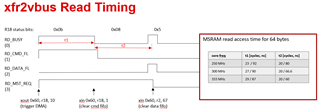

    is it possible, that there is an unexpected behavior with this step from the XFR2VBUS Programming Model?
    Quote: " Read:
    • Wait RD_BUSY = 0h
    • XOUT R18 (configure RD_AUTO/ RD_SIZE); R19 (RD_ADDR)
    Wait WR_BUSY = 0h OR RD_DATA_FL = 1h
    • XIN RD_DATA (Repeat if RD_AUTO is enabled and need new RD_DATA, must always check RD_DATA_FL before XIN RD_DATA) "
    Since i want to read, i guess i want to check the RD_BUSY and not the WR_BUSY right? If it is really the WR_BUSY, should i check register 20 in the read device id or in the corresponding write device id?
    I run this PRU Code in still in RTU 0 of PRU ICSSG0 in a SK-AM64 board (not the B variant). To check the status of the register 18 from the read device.

    As far as i understand "Table 6-516. Read Commands" from the TRM, bits 0-3 from register should be like this when the device is ready and i can read the data:
    R18[0] = RD_BUSY                    0b0 --> IDLE
    R18[1] = RD_CMD_FL               0b0 --> Empty (command is popped from the fifo after data has arrived)
    R18[2] = RD_DATA_FL              0b1 --> Occupied (I can get my data with an xin from the device)
    R18[3] = RD_MST_REQ           0b0 --> Data has been latched
    But this stage is never reached after a read command.

    Register 18 bits 0-3 will stay zero after my read command. But the command itself is beeing excuted. Have i misinterpreded somethin in the programming model?
    regards,
    Dominik
  • Hello Dominik,
    To confirm: It sounds like the broadside reads and writes are happening just like you expect, but now you are trying to double-check the logic of the register settings to do those reads and writes. Is that correct? Or are you actually seeing bad behavior for the XIN and XOUT commands?

    I got some input from another team member more experienced with xrf2vbus, hopefully this is helpful!
    Nick

  • Hello Nick,
    yesterday I was abled to verify the behaviour of the timing diagram you provided. Therefore I have to admitt there was a little bug in the C-code i provided earier. The 256byte buffer where i wanted to save the status of the RD_BUSY bit was to big for the stack.
    One thing i was wondering about was, that the read is done when R18 has the value 0x5. Compared to the programming modell for a read access from the TRM rev.F (p.3168):
    Read:
    • Wait RD_BUSY = 0h
    My suggestion would be to correct the highlighted line in the TRM of the AM64. (Maybe change it to: "Wait R18 =  0x05" ) To simply wait for bit 0 in R18 to be 0 didnt work in my tests.
    I will post my working PRU C-code on friday since I am short on time today.
    Dominik

    The status switches after the read command from: 0x0b to 0x08 to 0x05 like your diagramm said.
    Maybe this code helps someone with beginning to use the xfr2vbus accelerators on the am64x.
    If you have further questions feel free to contact me, and thank you for your help Nick!
