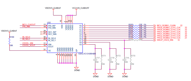

  • Jan,
      I see here three options.
    Default setting is RGMII interface with phy and SOC with own clock source.
    DP83867 has also MII mode which I would recommend for 100 Mbit testing. Description how to change to MII mode is in chapter 7 of EVM users guide.  https://www.ti.com/lit/ug/spruim6a/spruim6a.pdf
    Figure 3-4 of same document shows the clock tree for SoC and Ethernet Phy.
    Default option is that EPHYs and SOC run from different sources. There are 2 options.
    1. Use SOC clock source and route MCU_CLKOUT to clock buffer. Switch selection on clock buffer to MCU_CLKOUT.
    2. Use EPHY clock buffer source and route WKUP_OSC0_XIN from clock buffer to SoC. This option does not require any software change but only hardware mods with different resistor settings.
    We talk about clock synchronization in nano second range.  Linux OS is not sensitive to ns clock jitter.
    I recommend to start with clock modification option 2 first - only hardware changes.
    BR,
      Thomas
  • Thank you, Thomas, for your time and your insightful answer.
    We already have one board modified to use MII, but sending did not work and yesterday we were informed that MII mode is not supported by PRU FW provided for Linux.  Because of this lack of FW support, this modification is not usable for us, and we are currently planning to switch the modified board back to full RGMII configuration.
    I have to admit I was aware of the first possibility to switch the clock source, but somehow completely missed the second, better alternative.
    I think trying this out will be our next step.
    While Linux OS is not sensitive to ns clock jitter, time synchronization required for industrial control protocols are.  We are required to have 8 ns precision of timestamps because of the synchronization.  We have actually also other use cases requiring precise timestamps, all perfectly realizable with Linux userspace application.
