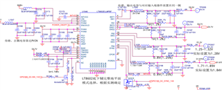

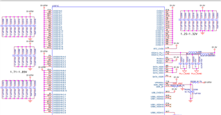

    The circuits dvdd18 and dvdd1833_x use the same power source, both 1.84 V. The following is the supply network for the power section:

    What is the power supply solution used?
    One supply is 1.28V and the other is 1.8V. Once the 1.28V power-up is complete, the 1.8V power-up begins. The power supply scheme is as follows:

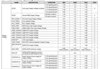

    My question is why is the 1.2V set to 1.28V?
    The chip is 456MHz version, so it is set to 1.28V such that cvdd,rvdd RTC_cvdd requires only one power supply.
    Below is the recommended power supply for the manual, 1.28V should be in the range?

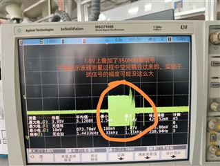

    The interference signal (350M carrier or modulation FSK encoding) superimposed on 1.8V is shown in the following figure:
    (Chinses on the figure means “A 350M RF signal is superimposed on 1.8V. It may be spatially coupled during the measurement, and the magnitude of the disturbance signal may not be as large in reality”)

  • Hello Cherry
    Thank you for the inputs.
    The above is the scope capture. of the 1.8V supply and thank you for the picture.
    I understand the signal being superimposed.Can you please help understand the coupling mechanism.
    Means how is the 350M getting coupled to the 1.8V. Would this be on all supply rails or only 1.8V.
    Sreenivasa
  • Hi Sreenivasa,
    On all supply rails.
    One is that the high power emissions of the equipment are spatially coupled, affecting the scope measurements.
    The other part affects B+/3.7V through power supply conduction (these two supplies directly power the RF amplifier) and then conducts to 1.8V.
    If the scope measurement is within a 20M bandwidth limit, the ripple at 1.8V is within 50mV.
