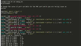

        We use BCM89834 to connect to port 1 of CPSW9G, and the phy has been linked, but I ping the directly connected PC through the eth1 network card, which is set on the same network segment, and the pings cannot be communicated with each other. I searched the forum and found that I can view the relevant packets through the script, the script is as follows
#!/bin/bash
# change the value of port variable for the MAC port which you are facing issue on
port=0
oport=$(( $port + $port ))
offset="0x$oport""00"
var=$(( 16#$(devmem2 0x0c03A034 | tail -n1 -c9) ))
echo "PORT0 good Tx frames    = $var"
var=$(( 16#$(devmem2 $( printf "0x%X\n" $(( 0x0c03a034 + $offset )) ) | tail -n1 -c9) ))
echo "PORT$port good Tx frames    = $var"
var=$(( 16#$(devmem2 $( printf "0x%X\n" $(( 0x0c03a000 + $offset )) ) | tail -n1 -c9) ))
echo "PORT$port good Rx frames    = $var"
var=$(( 16#$(devmem2 0x0c03A000 | tail -n1 -c9) ))
echo "PORT0 good Rx frames    = $var"
var=$(( 16#$(devmem2 0x0c03A028 | tail -n1 -c9) ))
echo "PORT0 ALE drop frames   = $var"
var=$(( 16#$(devmem2 $( printf "0x%X\n" $(( 0x0c03a028 + $offset )) ) | tail -n1 -c9) ))
echo "PORT$port ALE drop frames   = $var"
Execute the script on the board as follows,ifconfig shows the same result。And I also executed the check CPSW9G state script provided by ti to get the SGMII link status
What is the problem in this situation, and how can I further debug it?

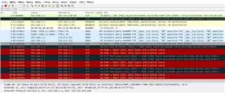

    What do you see on the host(PC) side? do you see any packets captures using wireshark or tcpdump?

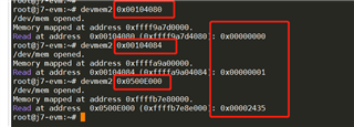

    Can you also share the value of following registers with me :
    • 0x00104080
    • 0x00104084
    • 0x0500E000

    PC-side wireshark captures packets, but there is no packet about 192.168.1.100

    log of “cat /sys/kernel/debug/remoteproc/remoteproc*/trace0”
    00000.000 TaskGetEnv: FATAL: NDK not initialized
    00000.000 fdOpenSession: OOM
    [NIMU_NDK] Registration of the ENET Successful
    root@j7-evm:~# [MCU2_0]    527.337386 s: DHCP client timed out. Retrying.....
    registers dump:
    There is a small problem, although I set a static ip, but mcu20 will report "DHCP client timed out. Retrying....", I don't know if this will affect
  • I also found a problem, that is ifconfig eth1 ip, it will always report an error, I feel that the ip has not been correctly set to MCU20
  • Now the phy has been adjusted, and the PC can be pinged normally, but there are still some problems, ifconfig eth1 ip will report an error, the bottom layer is the static arp addition failure, can you help me with this problem?
