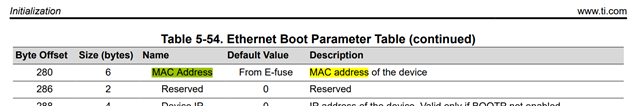

I wonder why the technical reference of the TI AM62x stated that the default MAC address is from Efuse? is this documentation error if we can't refuse the mac address on TI device?
We now have the instructions for programming the OTP efuses for the MAC address at https://e2e.ti.com/support/processors-group/processors/f/processors-forum/1235880/faq-how-to-update-ids-usb-pcie-pid-vid-mac-id-by-programming-extended-otp-on-am6x .
The eeprom based approach will also work as well.
