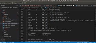

We were getting compilation error when we configure "L2dmemory" to "L2RAM_C7x_1". So we configured "L2dmemory" to "DDR_C7x_1" in "ti-processor-sdk-rtos-j721e-evm-08_02_00_05_lin_evm/vision_apps/platform/j721e/rtos/c7x_1/j721e_linker_freertos.cmd" file. Below screenshot for your reference.
Now the compilation is fine and getting run time error ie, application is getting stuck in the middle and getting garbage values.

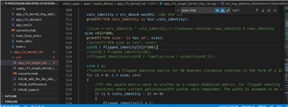

Suppose my image size is 512x512 I need to create one flipped identity matrix with size of 512x512.
Currently I am hardcoding the values for testing so if my array size is more than 512x200 (>100kb) am reading garbage values for the other parameters in the code. Below screenshot with array size of 320x320 it works fine but still execution stuck.
below screenshot with array size of 512x300. Am getting garbage value.
 app_c7x_target_kernel_img_rot.cpp
I have attached the cpp file for your reference. Please look into the "static vx_status rot_img_pipeline_blocks" function. Line number 440.
The execution stuck at line number 564.

  • Hello Vineeth,
    There is an issue with l2dmemory and the matrixTranspose function that have been fixed in the latest release.  Please see https://e2e.ti.com/support/processors-group/processors/f/processors-forum/1176001/tda4vm-error-with-c7x-namespace-while-building-vision-apps-integrated-with-mmalib
    Please note that defining the l2dmemory section does not work; the only known fix is to upgrade per the post above.

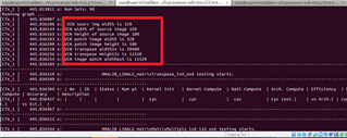

  • Hi William,
        Thank you very much for your valuable inputs. Most of the issues I resolved now, am getting data in "inputpSrc0L2" variable (input to the matrixTranspose).
    But now I have facing other issue. With hardcoded values I am trying to test the matrixTranspose. I have observed that matrixTranspose is working fine only with square matrix (for ex: 3x3 matrix). In my test I have given 4x3 matrix but the output I am getting is only 3x3 and the last row in this case became filled with zeros. Below screenshot for your reference.
    The actual image I am trying to transpose is 320x180 so due to the above issue my transposed array is filled with zeros in some part. Attached is the code for your reference. Please let me know if i am doing anything wrong.
    Highly appreciate if you could help me quickly.

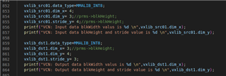

  • Vineeth,
    Looks like you've made great progress and are almost there.  One quick fix and I think you'll have the hardcoded matrix transposing.  The current code you sent me has
       vxlib_src01.data_type=MMALIB_INT8;
       vxlib_src01.dim_x= 4;
       vxlib_src01.dim_y= 3;//prms->blkHeight;
       vxlib_src01.stride_y= 3;//prms->blkHeight;
       printf("VCN: Input data blkWidth valus is %d \n",vxlib_src01.dim_x);
       printf("VCN: Input data blkHeight and stride value is %d \n",vxlib_src01.dim_y);
       vxlib_dst1.data_type=MMALIB_INT8;
       vxlib_dst1.dim_x= 3;//prms->blkHeight;
       vxlib_dst1.dim_y= 4;
       vxlib_dst1.stride_y= 4;
    The definition of the "stride_y" field of MMALIB_bufParams2D_t (i.e. vxlib_src01.stride_y and vxliv_dst1.stride_y) is the number of bytes from the beginning of one row to the beginning of the next.  Assuming there are no gaps in your data, this would mean that vxlib_src01.stride_y == vxlib_src01.dim_x (i.e. the width of the matrix).  Your current code is instead using the height (vxlib_src01.dim_y) of the matrix for this parameter.
    If you change this bit of code to this, it should work...
       vxlib_src01.stride_y= 4;//prms->blkWidth;  CHANGED THIS...
       printf("VCN: Input data blkWidth value is %d \n",vxlib_src01.dim_x);
       vxlib_dst1.stride_y= 3; // ...AND CHANGED THIS TOO
    -Will

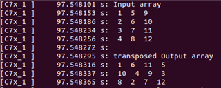

        After doing the changes as you mentioned, am not getting the o/p as expected. Attached are the o/p and code changed screenshot for your reference.
    Thanks and regards,
    Vineeth

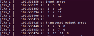

  • Hi Willam,
      Am still getting wrong transposed output. Attached the code and output screenshot.
    Thanks and Regards,
    Vineeth
  • In this case (and normally) stride_y should be equal to dim_x.  When you swapped dim_x and dim_y, stride_y also needed to change.
  • Thank you so much William. Am getting correct output now. I will work on my actual image matrix now. Appreciate your quick help.
    Vineeth
