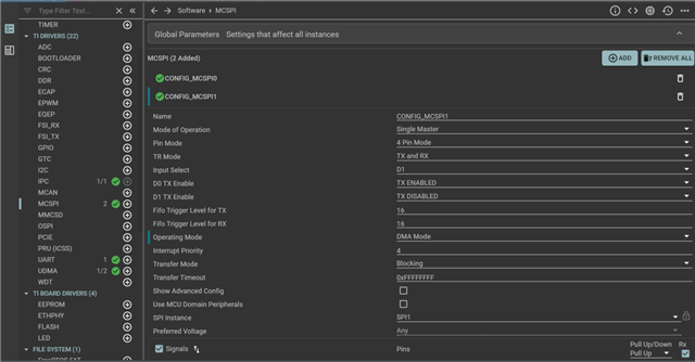

Customer have integrated the IPC RP Message Linux Echo into the SPI project. Customer has the UART1 for IPC communication and for the MCSPI project  have 2 SPI channels which is using the DMA mode operation(with UDMA PKTDMA_0). After integrating the MCSPI project and echo Linux, No (IPC RPMSG ECHO)messages were showing on the USART1 console.
After changed the mode of operation from DMA to Interrupt for the SPI channels, they able to get the logs in UART1 console.
Do they need to change any pin configuration or any settings in sys config for DMA to work for MCSPI?
MCSPI settings with DMA mode(not working):
MCSPI settings with Interrupt mode(working):

    As per your comments customer is using two MCSPI channels with DMA mode but I see single MCSPI channel +DMA in sysconfif file .
    Can you please share the actual sysconf file that uses 2MCSPI channels + DMA.
    I need to check how they have allocated DMA channels for 2MCSPI channels as they are facing problem in DMA and not in interrupt mode.
    S.Anil.
  • Hi Swargam
    Attached the config file and shared the project with 2 MCSPI channels with DMA mode.

    I looked at your sysconfig file and software changes.
    I found that you missed the initialization of the UDAM for the MCSPI channel in the software.

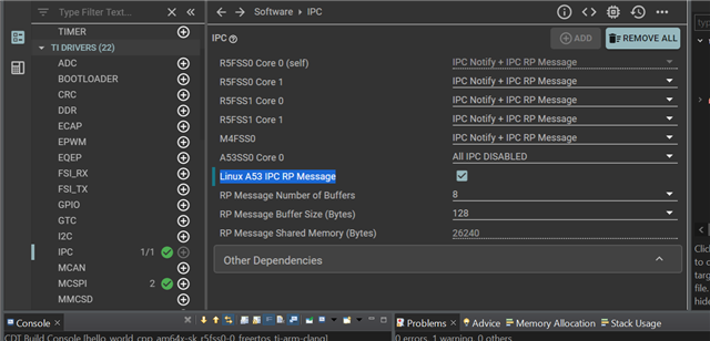

    • When we use interrupt mode the UDMA driver is not initialized. – RPMsg char device creation succeeds
    • When we introduce MCSPI with DMA mode during system init the UDMA driver is initialized.  – RPmsg char device creation fails
    • UDMA initialization failure shall not prevent rpmsg_chrdev channel creation

    After quick review through ipc_rpmsg_echo_linux_am64x-evm_r5fss0-0_freertos_ti-arm-clang-ipcDMATest, the Linux RPMsg settings look the way I would expect. However, I did not see any McSPI code in the .c files. Am I missing something? Or have you only enabled McSPI in the SysConfig settings without adding any code at this point in time?
    [Customer] We enabled MCSPI in the SysConfig settings without adding any application code for the UDMA.

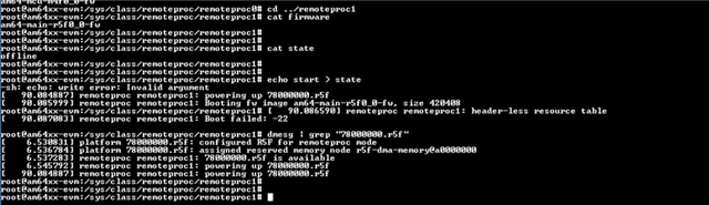

  • Accidentally deleted Venkata's reply. re-posting it here:
    I have took the helloworld cpp project and added empty resource table as mentioned in "examples/drivers/ipc/ipc_rpmsg_echo_linux/am62x-sk/m4fss0-0_freertos/ti-arm-clang/linker.cmd" and enabled the Rpc IPC setting and loaded. With the change I am getting the Hello_World print.
    After that I have added MCSPI with DMA and compiled and tested and this time I couldn't see Hello world Print.
    Then I loaded the helloword*.out file through CCS and it was asserting in udma init.

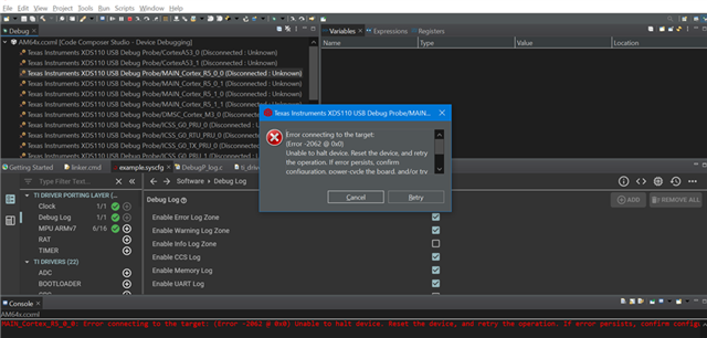

  • Regarding TEST 2: Is RPMsg causing the issue, or is it something else?
    In the same helloworld project, I made Linux to load the remote core WITHOUT Linux IPC / RPMsg enabled then core it self is not loading. Event I tried rebooting still the result is same.
    Core Stop/start:
    With Reboot:
    When I tried loading from the ccs getting an error to load:
    After adding the Linux A53 IPC RP Message, I can see core is loading.
  • We tried Helloworld with "Linux A53 IPC RP Message" enabled and added two MCSPI line with PKT DMA configuration and loaded from linux, then we don't see any "Hello World!" print.
    When change from DMA to Interrupt in MCSPI then we are getting the debug logs, here DMA is causing the issue:
  • Did you notice that line in the terminal output "header-less resource table"? That means the resource table either does not exist in the project, or is not formatted properly.
    Please try to follow the steps in the FAQ again. I have posted a reply there to help.
    https://e2e.ti.com/support/processors-group/processors/f/processors-forum/1193620/faq-am62x-am64x-how-to-allow-linux-to-load-m4f-r5f-firmware-by-adding-a-resource-table/4503953#4503953
    Please try either approach 2A, or 2B. If you are unable to add a resource table as demonstrated, please attach your project in the e2e ticket for us to review.
    Nick

  • HI Anil,
    When I tried to load the helloworld project with MCSPI_DMA using CCS, I also ended up asserting in the same location.
    Our use case is to load the r5 cores from the linux boot not from the CCS.

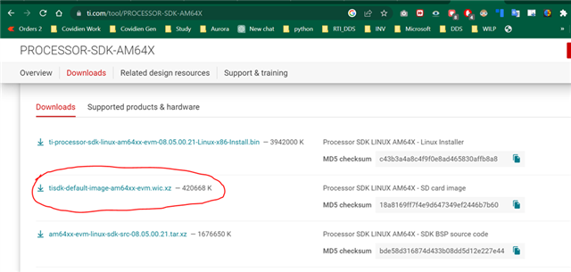

    Create a new SD card with the Linux SDK 8.5 image: software-dl.ti.com/.../Processor_SDK_Linux_create_SD_card.html
    [Venkat] I have used the SKAM64x Linux SDK image.
