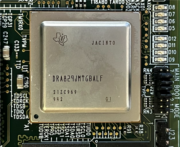

  • Hi Keerthy,
    Do you know the exact variant of J721E that is on the EVM?.  Because of the heatsink, I can't see that.  Here is what I'm using:

  • I am now able to boot all the way to u-boot.  I found an error in the LPDDR4 h/w that luckily was an easy fix (ZQ0/1 connect to 1.1V not 1.8V)
  • A request to TI.  Please document what changes are required in the bootloader configs to support custom h/w.
    For instance documenting that the USB subsystem needs to know in defconfig what the reference clock frequency is.
    Others include what to change if you have an LPDDR4 size of other than 4GB
    Thanks!
