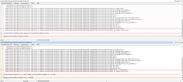

    The detailed modification steps are as follows:
    1、Change the name of k3-am625-sk.dts to k3-am625-sk-user.dts
    2、Add k3-am625-sk-user.dtb to the Makefile in the /arch/arm/dts directory, so that it can compile the newly added device tree file
    3、Change CONFIG_DEFAULT_DEVICE_TREE="k3-am625-sk" of am62x_evm_a53_defconfig in the configs directory to CONFIG_DEFAULT_DEVICE_TREE="k3-am625-sk-user"
    4、Recompile the R5 core:

    On which board the non-working log was captured?
    -Hong
    AM62x SK EVM PROC114E3
    Processor SDK RT-Linux for AM62x 08.05.00.21
    There're additional references to "k3-am625-sk" in u-boot SRC tree which are not in the code change list in your last reply.
    Will you cross check again?
    -Hong
    All the places searched by the customer using the command grep -r "k3-am625-sk" have been modified, but it still cannot be boot up? Please confirm whether the customer's compilation command is correct? If there is no problem, could you please give a detailed implementation process?
    Can you add the newly added code change items in addition to the previouis list?
    Will you upload the full boot log with the latest code modifications?

  • Hi ,
    Root Cause
    After much debugging, I think I have found the problem. So, I was analyzing the building logs and found the below difference
    The above seems to suggest that on using custom file name somehow the two .dtsi files k3-am625-sk-u-boot.dtsi and k3-am625-sk-common-u-boot.dtsi are not getting picked which results in A53 U-Boot SPL not booting.
    Solution
    After suspecting the above difference is creating the problem, I renamed k3-am625-sk-u-boot.dtsi to k3-am625-sk-user-u-boot.dtsi & also updated the references in the source code (there is only one). Then after building, I could see that all the .dtsi are getting picked
    Then, after replacing the files on the SD card, I could finally boot A53 SPL & then U-Boot successfully.
    The exact changes I do are shown below as git diff

     CONFIG_SPL_SPI_SUPPORT=y
    -CONFIG_DEFAULT_DEVICE_TREE="k3-am625-sk"
    +CONFIG_DEFAULT_DEVICE_TREE="k3-am625-sk-user"
     CONFIG_DISTRO_DEFAULTS=y
     # CONFIG_SYS_MALLOC_CLEAR_ON_INIT is not set
     CONFIG_FIT_IMAGE_POST_PROCESS=y
    Let us know if the above changes work for you also.
    Prashant
  • Hi Prashant,
    I tried the method you said, u-boot can start up normally.  Thank you very much.
  • Hi zhoukaide,
    Good to know it is working for you also. Next, please let me know if I can close thread in case of no further questions.
    Prashant
