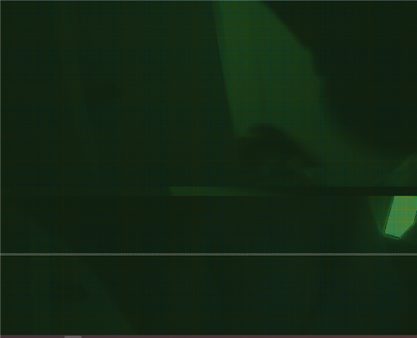

        I have met a weird issue on TDA4VM Edge AI Starter Kit platform, I  am developing  frame grabber now  on it, We need capture bayer raw data (format: 3586X2177@30hz) from image sensor and send it to PC host   by PCIE interface. It was worked when i   used v4l2  method  to capture video data  and  it worked also when i  send test datas to PC(worked as RC mode) by pcie interface  (which deviced work as  EP mode)  based on linux epf test driver(pci-epf-test.c) origented from kernel source of ti-processor-sdk-linux-j7-evm-08_04_00_11 .
       But  when i integrated these 2 functions  worked at the same time which meaned capture mipi-csi data and send it to host together.  I found the video data were error from v4l2 driver, It seemed some video frames were mixed up. I guessed some dma  transmit  work wrong on linux mipi-csi driver . some one can help me to fix this bug? I am grateful for your help。
    Could you please provide detailed steps what you are following?
    We could review this and try to reproduce the same at our end.
    Nikhil
  • steps:
    1: connect the pcie1(j22)  to  host PC(x86+ubuntu18.04).
    2: config the pcie1 of  sk-evm run as pcie endpoint just as the the instruction processor-sdk-linux-docs/docs/linux/Foundational_Components/Kernel/Kernel_Drivers/PCIe/PCIe_End_Point.html
    3: Run  pcitest.sh on  PC  side to send "read" command  always, (it is easily do to change the script to support it)
    4:run yavta on board to capture vide ,command like  "yavta /dev/video2 -c10 -n4 -s3856x2177 -fUYVY -Ftest_video.raw ", of course,we changed the v4l2 driver to support my sensor which support 3856X2177@30hz ,. You can capture used default sensor imx219 image too.  just like command "yavta /dev/video2 -c1 -n4 -s1920x1080 -fSRGGB10 -Ftest_video.raw"
    5: used yuv tool just like 7yuv to view the video file test_vide.raw. you will find this issue.

    Please let me know if my understanding is correct here regarding the issue.
                                        USECASE         STATUS
    1. Yavta capture alone            OK
    2. PCIE test alone           OK
    3. Yavta capture stored all frames and then
     frames are shared via PCIE
    OK or NOT OK??
    4. Live transmission of Yavta capture and each capture being
    sent via PCIE simultaneously.
           NOT OK
    Could you confirm if the 3rd usecase is OK or NOT OK?
    Nikhil

        Yes,You summarized it very well. it is ok for 3 too.    It was ok when we send some fixed image  by PCIE.
        I can supplement an idea that I can use a low resolution such as 640X480 (RGB format) from a UVC camera for real-time capture and PCIe transmission,It was work too.
  • hi Nikhil,can you have some new idea about this issue?
  • I have checked dma channels ,the mipi-csi driver  used dma applied channel from 1 to 35  at fist (ti_csi2rx_init_dma()) but only used 1, The pcie applied dma channel 36 and used it, no  found  dma channel conflict .
    Could you do the same experiment with a lower resolution input data that uses csi-rx? (As UVC does not use csi-rx)
    Could you also enable the trace logs or get timestamps from the csi-rx driver and the pcie. As this could be seen if the real time contraints are not met (i.e., if pcie is slow and csi-rx is fast, there are chances that the frames are dropped or corrupted)
    Could you profile both to confirm if this is happening in your case?
    Meanwhile could you share your kernal (boot) logs? Wanted to check if there are any resource errors here.
    Nikhil

  • hi Nikhil:
        I have got tested result  with imx219 here:
    1: VGA and no pcie transmit,  video ok
    2: VGA and  pcie , video ok
    3: 1080p and no pcie ,video ok
    4: 1080p and pcie , video not ok
    what do you think about it?
  •    Picture like this from sensor imx219

  • I have found some driver log : "Failed to drain DMA. Next frame might be bogus"  if we run  pcie at the same time. and no pcie no this log. Is it helpful to resolve  the issue?
    This usually comes when there are frame drops.
    We could first confirm if this is the case by reducing the fps.
    Post that, I think we could either try increasing the number of buffers provided to csi-rx. I think, currently it is 4 (may be we could try increasing it to 6 and test this)
    Nikhil
