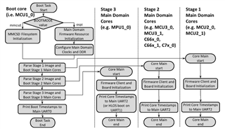

Follow below process to booting linux kernel. I have tested that how long does it take to output  kernel log on SOC uart after power-on.
It takes about 4.3s by OSPI Boot media and about 13.8s by emmc Boot media.
1. I wonder if the booting time are within the expected range.
2. How to reduce emmc booting time?
3. If  emmc booting time can be optimized as OSPI booting time?

  • Hi:
    1.   OSPI booting log on mcu uart:
    Starting Sciserver..... PASSED
    OSPI flash left configured in Legacy SPI mode.
     OSPI NOR device ID: 0x5b1a, manufacturer ID: 0x2c

    MCU Boot Task started at 57 usecs and finished at 9229048 usecs
    2. emmc bootting log on mcu uart:

    Boot App: Started at 3112 usec
    Boot App: Stage 0 - Started requesting all cores at 400070 usec
    Boot App: Stage 0 - Completed requesting all cores at 519158 usec
    Boot App: Stage 0 - Started copying and image parsing at 538103 usec
    Boot App: Stage 0 - Completed copying and image parsing at 1162104 usec
    Boot App: Stage 0 finished at 1426104 usecs
    Boot App: Stage 1 - Started requesting all cores at 1426104 usec
    Boot App: Stage 1 - Completed requesting all cores at 1728157 usec
    Boot App: Stage 1 - Started copying and image parsing at 1747103 usec
    Boot App: Stage 1 - Completed copying and image parsing at 4063104 usec
    Boot App: Stage 1 finished at 4565104 usecs
    Boot App: Stage 2 - Started requesting all cores at 4565104 usec
    Boot App: Stage 2 - Completed requesting all cores at 4626159 usec
    Boot App: Stage 2 - Started copying and image parsing at 4645103 usec
    Boot App: Stage 2 - Completed copying and image parsing at 10987170 usec
    Boot App: Stage 2 finished at 11143104 usecs
    Boot App: Total Num booted cores = 6
    Boot App: Booted Core ID #10 at 1362104 usecs
    Boot App: Booted Core ID #11 at 1426104 usecs
    Boot App: Booted Core ID #16 at 4424104 usecs
    Boot App: Booted Core ID #17 at 4494104 usecs
    Boot App: Booted Core ID #18 at 4565104 usecs
    Boot App: Booted Core ID #0 at 11143104 usecs
    MCU Boot Task started at 3112 usecs and finished at 16484103 usecs
    I found that it takes more time coping and parsing image from emmc than from ospi.
    Q: I wonder if emmc booting time can be optimized. Or  it can not be optimized as limited by emmc access speed.

    Apologies for the long delay. Now eMMC boot is part of 8.6 SDK.
    https://e2e.ti.com/support/processors-group/processors/f/processors-forum/1249052/tda4al-q1-how-to-optimize-the-emmc-startup-time-in-sbl-mode#:%7E:text=Hi%2C%0A%0AAre,for%20eMMC%20Boot0%3F
    The above thread has relevant numbers. Please follow that.
