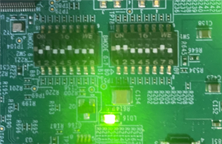

The configuration of Boot SWITC is based on the following URL.
https://dev.ti.com/tirex/explore/node?node=A__ADkBFm4ReTIZYz1OmNNnpA__linux_academy_am62x__XaWts8R__LATEST&search=am62
They are able to BOOT via UART, and they are able to Boot by reading the file system from SD after UART BOOT.

  • Hi O.H,
    When the customer wasn't able to boot SK-AM62 from SD card with SDK v8.5, does the serial console print any log message? If so, please share the log. If the serial console doesn't print any message, please share the picture of the sysboot switches of the board. I'd like to ensure it has been set properly for SD card boot.
    Please also note that when switching the boot mode from UART to SD card boot, you need to power cycle the board, as warm reset won't re-latch the sysboot settings.

    Both states of the sysboot switch are tried in the figure below.
    I understood.
    O.H

    From the hardware perspective, do you see any difference between the LEDs being ON for the E2 and the E3 board.
    Sreenivasa
  • Hello Sreenivasa,
    Thank you for your reply.
    The LED patterns are the same on the E2 and E3 boards when booted from the SD card (tiboot3.bin) as shown in the figure below.

  • Hello O.H,
    It seems SD boot settings might not be getting latched properly for some reason.
    Since the same board was working before, Can you confirm if there was any changes to the board or any specific software testing after which board started failing to boot from SD card?
    Senthil
  • Hello Senthil,
    What the customer has done is about the following
    • Change to board
      • Repeatedly switched DipSw between OSPI Boot and SD Boot to verify OSPI Boot.
      • No changes or modifications to Hardware.
    • Software
      • Delete all data in the existing partition (mtd*) of OSPI Flash, change the partition, and write the binary (tiboot3.bin, spl.bin, u-boot.img, etc.)
      • After deleting all the contents of EEPROM, write parameters used in customer programs.
    O.H

    I believe some boot pins might have got stuck at one logic. We will try to get you boot switch diagnostic test on UART boot. I will update you.

  • Hello Sreenivasa,
    Would it be possible to probe the bootmode pins - to confirm the bootmode being set matches with the required bootmode.
    They had already checked the voltage, but the output voltage was as intended by the DIPSW.
