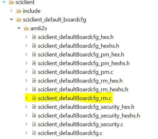

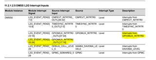

    Software Changes :
    1. Configure GPIO as an input based on your requirements.
     In my example, I have configured GPIO1_23, which is available on EVM.
    2. Route the Main GPIO Interrupt Router outputs from 22 to 31 to L2G. Since these routers only connect to L2G.
    Please see the below image.
    Unfortunately, in the software, these routers are not routed to L2G.
    So, I have manually updated only the main GPIO router outputs from 22 to 31 in the sciclient_defaultBoardcfg_rm.c file.
    Folder Path:
    C:\ti\mcu_plus_sdk_am62x_08_06_00_18\source\drivers\sciclient\sciclient_default_boardcfg\am62x
    3. Compile the sciclient_defaultBoardcfg_rm.c file by using below link.
    https://e2e.ti.com/support/processors-group/processors/f/processors-forum/1198105/faq-am64x-how-to-run-mcu-sdk-gpio_input_interrupt-example-for-r5fss0-0-with-linux-running-on-a53
    https://e2e.ti.com/support/processors-group/processors/f/processors-forum/1181741/am6442-how-r5-core-boot-as-processor-linux-sdk-then-load-mcu-plus-sdk-ccs-r5-demo/4490754#4490754

    In the application, please check the below function for more details about converting a GPIO Event to a global event.
    static void configure_intaggrL2G (uint32_t localEvent, uint32_t globalEvent)
    uint64_t eventRegOffset = CSL_DMASS0_INTAGGR_L2G_BASE + (localEvent * 0x20U);
    CSL_REG32_WR(eventRegOffset, (0U << 31U) | (globalEvent & 0xFFFFU) ); /* pulse event */
    5. Compile SBL and Flash SBL with the updated board configuration file.
    6. Run your Application from CCS.
    Please let me know if you need any other help.
    The below link can be helpful to configure GPIO Routers and other Routers .
    https://software-dl.ti.com/tisci/esd/latest/5_soc_doc/am62x/interrupt_cfg.html
    For your requirement in the Software , you just need to update the below parameter in the function.
    rmIrqReq.src_index = 182U; //GPIO1_45 and Bank 2
