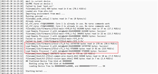

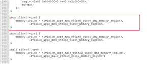

TDA4AL-Q1: [TDA4vm] SBL runs Linux system stuck
Part Number: TDA4AL-Q1
Other Parts Discussed in Thread: TDA4VM
I'm using version 0806 and there's nothing wrong with running the system on SPL, but I switch to SBL and it gets stuck when the linux kernel runs
Below is the running log of SBL and SPL

sbl_linux:
NOTICE:  BL31: v2.8(release):v2.8-226-g2fcd408bb3-dirty
[2023-03-30 16:16:33]  NOTICE:  BL31: Built : 17:56:46, Mar  1 2023
[2023-03-30 16:16:33]  ERROR:   GTC_CNTFID0 is 0! Assuming 200000000 Hz. Fix Bootloader
[2023-03-30 16:16:33]  I/TC:
[2023-03-30 16:16:33]  I/TC: OP-TEE version: 3.20.0 (gcc version 9.2.1 20191025 (GNU Toolchain for the A-profile Architecture 9.2-2019.12 (arm-9.10))) #1 Wed Mar  1 17:56:56 UTC 2023 aarch64
[2023-03-30 16:16:33]  I/TC: WARNING: This OP-TEE configuration might be insecure!
[2023-03-30 16:16:33]  I/TC: WARNING: Please check https://optee.readthedocs.io/en/latest/architecture/porting_guidelines.html
[2023-03-30 16:16:33]  I/TC: Primary CPU initializing
[2023-03-30 16:16:33]  I/TC: SYSFW ABI: 3.1 (firmware rev 0x0008 '8.6.3--v08.06.03 (Chill Capybar')
[2023-03-30 16:16:33]  I/TC: HUK Initialized
[2023-03-30 16:16:33]  I/TC: Activated SA2UL device
[2023-03-30 16:16:33]  I/TC: Fixing SA2UL firewall owner for GP device
[2023-03-30 16:16:33]  I/TC: Enabled firewalls for SA2UL TRNG device
[2023-03-30 16:16:33]  I/TC: SA2UL TRNG initialized
[2023-03-30 16:16:33]  I/TC: SA2UL Drivers initialized
[2023-03-30 16:16:33]  I/TC: Primary CPU switching to normal world boot
[2023-03-30 16:16:33]  [    0.000000] Booting Linux on physical CPU 0x0000000000 [0x411fd080]
[2023-03-30 16:16:33]  [    0.000000] Linux version 5.10.162-g76b3e88d56 (root@DESKTOP-BKL7HPR) (aarch64-none-linux-gnu-gcc (GNU Toolchain for the A-profile Architecture 9.2-2019.12 (arm-9.10)) 9.2.1 20191025, GNU ld (GNU Toolchain for the A-profile Architecture 9.2-2019.12 (arm-9.10)) 2.33.1.20191209) #7 SMP PREEMPT Thu Mar 30 16:12:36 CST 2023
[2023-03-30 16:16:33]  [    0.000000] Machine model: Texas Instruments J721S2 EVM
[2023-03-30 16:16:33]  [    0.000000] earlycon: ns16550a0 at MMIO32 0x0000000002880000 (options '')
[2023-03-30 16:16:33]  [    0.000000] printk: bootconsole [ns16550a0] enabled
[2023-03-30 16:16:33]  [    0.000000] efi: UEFI not found.
[2023-03-30 16:16:33]  [    0.000000] [Firmware Bug]: Kernel image misaligned at boot, please fix your bootloader!
[2023-03-30 16:16:33]  [    0.000000] Reserved memory: created DMA memory pool at 0x00000000a0000000, size 1 MiB
[2023-03-30 16:16:33]  [    0.000000] OF: reserved mem: initialized node vision-apps-r5f-dma-memory@a0000000, compatible id shared-dma-pool
[2023-03-30 16:16:33]  [    0.000000] Reserved memory: created DMA memory pool at 0x00000000a0100000, size 15 MiB
[2023-03-30 16:16:33]  [    0.000000] OF: reserved mem: initialized node vision-apps-r5f-memory@a0100000, compatible id shared-dma-pool
[2023-03-30 16:16:33]  [    0.000000] Reserved memory: created DMA memory pool at 0x00000000a1000000, size 1 MiB
[2023-03-30 16:16:33]  [    0.000000] OF: reserved mem: initialized node vision-apps-r5f-dma-memory@a1000000, compatible id shared-dma-pool
[2023-03-30 16:16:33]  [    0.000000] Reserved memory: created DMA memory pool at 0x00000000a1100000, size 15 MiB
[2023-03-30 16:16:33]  [    0.000000] OF: reserved mem: initialized node vision-apps-r5f-memory@a1100000, compatible id shared-dma-pool

spl_linux:
[2023-03-30 16:19:09]  U-Boot SPL 2021.01 (Mar 30 2023 - 10:13:36 +0800)
[2023-03-30 16:19:09]  ti_sci system-controller@44083000: Message not acknowledgedSYSFW ABI: 3.1 (firmware rev 0x0008 '8.6.3--v08.06.03 (Chill Capybar')
[2023-03-30 16:19:09]  EEPROM not available at 0x50, trying to read at 0x51
[2023-03-30 16:19:09]  Reading on-board EEPROM at 0x51 failed 1
[2023-03-30 16:19:09]  Trying to boot from MMC2
[2023-03-30 16:19:10]
[2023-03-30 16:19:10]  U-Boot 2021.01 (Mar 30 2023 - 10:13:36 +0800)
[2023-03-30 16:19:10]  SoC:   J721S2 SR1.0 GP
[2023-03-30 16:19:10]  Model: Texas Instruments J721S2 EVM
[2023-03-30 16:19:10]  EEPROM not available at 0x50, trying to read at 0x51
[2023-03-30 16:19:10]  Reading on-board EEPROM at 0x51 failed 1
[2023-03-30 16:19:10]  Board: J721S2X-PM1-SOM rev E1
[2023-03-30 16:19:10]  DRAM:  2 GiB
[2023-03-30 16:19:10]  Flash: 0 Bytes
[2023-03-30 16:19:10]  MMC:   mmc@4f80000: 0, mmc@4fb0000: 1
[2023-03-30 16:19:10]  In:    serial@2880000
[2023-03-30 16:19:10]  Out:   serial@2880000
[2023-03-30 16:19:10]  Err:   serial@2880000
[2023-03-30 16:19:10]  am65_cpsw_nuss ethernet@46000000: K3 CPSW: nuss_ver: 0x6BA02102 cpsw_ver: 0x6BA82102 ale_ver: 0x00293904 Ports:1 mdio_freq:1000000
[2023-03-30 16:19:10]  Net:   eth0: ethernet@46000000port@1
[2023-03-30 16:19:10]  Hit any key to stop autoboot:  0
[2023-03-30 16:19:10]  switch to partitions #0, OK
[2023-03-30 16:19:10]  mmc1 is current device
[2023-03-30 16:19:10]  SD/MMC found on device 1
[2023-03-30 16:19:10]  Failed to load 'boot.scr'
[2023-03-30 16:19:10]  filename[uEnv.txt] 484 bytes read in 6 ms (78.1 KiB/s)
[2023-03-30 16:19:10]  Loaded env from uEnv.txt
[2023-03-30 16:19:10]  Importing environment from mmc1 ...
[2023-03-30 16:19:10]  Running uenvcmd ...
[2023-03-30 16:19:10]  filename[.psdk_setup] 1 bytes read in 7 ms (0 Bytes/s)
[2023-03-30 16:19:10]  Already setup.
[2023-03-30 16:19:10]  k3_r5f_rproc r5f@41000000: Core 1 is already in use. No rproc commands work
[2023-03-30 16:19:10]  k3_r5f_rproc r5f@41400000: Core 2 is already in use. No rproc commands work
[2023-03-30 16:19:10]  filename[/lib/firmware/j721s2-main-r5f0_0-fw] 662600 bytes read in 37 ms (17.1 MiB/s)
[2023-03-30 16:19:10]  Load Remote Processor 2 with data@addr=0x82000000 662600 bytes: Success!
[2023-03-30 16:19:10]  filename[/lib/firmware/j721s2-main-r5f0_1-fw] 306092 bytes read in 22 ms (13.3 MiB/s)
[2023-03-30 16:19:10]  Load Remote Processor 3 with data@addr=0x82000000 306092 bytes: Success!
[2023-03-30 16:19:10]  Failed to load '/lib/firmware/j721s2-main-r5f1_0-fw'
[2023-03-30 16:19:10]  Failed to load '/lib/firmware/j721s2-main-r5f1_1-fw'
[2023-03-30 16:19:10]  filename[/lib/firmware/j721s2-c71_0-fw] 14749760 bytes read in 278 ms (50.6 MiB/s)
[2023-03-30 16:19:11]  Load Remote Processor 6 with data@addr=0x82000000 14749760 bytes: Success!
[2023-03-30 16:19:11]  filename[/lib/firmware/j721s2-c71_1-fw] 9768888 bytes read in 81 ms (115 MiB/s)
[2023-03-30 16:19:11]  Load Remote Processor 7 with data@addr=0x82000000 9768888 bytes: Success!
[2023-03-30 16:19:11]  filename[/boot/Image] 18678272 bytes read in 775 ms (23 MiB/s)
[2023-03-30 16:19:12]  filename[/boot/k3-j721s2-common-proc-board.dtb] 82840 bytes read in 10 ms (7.9 MiB/s)
[2023-03-30 16:19:12]  filename[/boot/k3-j721s2-vision-apps.dtbo] 9946 bytes read in 7 ms (1.4 MiB/s)
[2023-03-30 16:19:12]  ## Flattened Device Tree blob at 88000000
[2023-03-30 16:19:12]     Booting using the fdt blob at 0x88000000
[2023-03-30 16:19:12]     Loading Device Tree to 000000008fee8000, end 000000008fffffff ... OK
[2023-03-30 16:19:12]  Starting kernel ...

Through comparison, it was found that the log "smp: Bringing up secondary CPUs ..." was stuck ,Seems to be waiting for CPU1 to run
I also found that when SBL is running command_line it is also different from SPL, do I need to pay attention? Or the difference between SBL and SPL

  • The picture is the IMAG where I do the Combine app,I followed the steps of this link to do SBL,[FAQ] TDA4VM: Run vision_apps in SBL boot flow with combined_appImage - Processors forum - Processors - TI E2E support forums

    I don't think we have to disable the serdes in J721s2 (TDA4AL) on linux. Could you please remove "status = disable" from serdes in the patch in FAQ?
    Also, I believe you have taken the vision_apps reserved section from the J721s2 dts file and not the one in the patch right?
    You could refer this thread. (+) TDA4VL-Q1: vision_apps failed with SBL boot mode - Processors forum - Processors - TI E2E support forums
    It is for SDK 8.5 J721s2, but I think it should work for this too.

    +&mcu_r5fss0_core0 {
    +	status = "disabled";
    +	memory-region = <&vision_apps_mcu_r5fss0_core0_dma_memory_region>,
    +			<&vision_apps_mcu_r5fss0_core0_memory_region>;

    Above is k3-j721s2-common-proc-board.dts file which I modified it according to the link you provided, but it didn't work and Linux is still stuck ,the  log below
    I/TC:
    [    0.000000] Linux version 5.10.162-g76b3e88d56 (root@DESKTOP-BKL7HPR) (aarch64-none-linux-gnu-gcc (GNU Toolchain for the A-profile Architecture 9.2-2019.12 (arm-9.10)) 9.2.1 20191025, GNU ld (GNU Toolchain for the A-profile Architecture 9.2-2019.12 (arm-9.10)) 2.33.1.20191209) #1 SMP PREEMPT Mon Apr 3 09:44:11 CST 2023
    [    0.000000] Reserved memory: created DMA memory pool at 0x00000000a2000000, size 1 MiB
    [    0.000000] OF: reserved mem: initialized node vision-apps-r5f-dma-memory@a2000000, compatible id shared-dma-pool
    [    0.000000] Reserved memory: created DMA memory pool at 0x00000000a2100000, size 31 MiB
    [    0.000000] OF: reserved mem: initialized node vision-apps-r5f-memory@a2100000, compatible id shared-dma-pool
    [    0.000000] Reserved memory: created DMA memory pool at 0x00000000a4000000, size 1 MiB
    [    0.000000] OF: reserved mem: initialized node vision-apps-r5f-dma-memory@a4000000, compatible id shared-dma-pool
    [    0.000000] Reserved memory: created DMA memory pool at 0x00000000a4100000, size 31 MiB
    [    0.000000] OF: reserved mem: initialized node vision-apps-r5f-memory@a4100000, compatible id shared-dma-pool
    [    0.000000] Reserved memory: created DMA memory pool at 0x00000000a6000000, size 1 MiB
    [    0.000000] OF: reserved mem: initialized node vision-apps-r5f-dma-memory@a6000000, compatible id shared-dma-pool
    [    0.000000] Reserved memory: created DMA memory pool at 0x00000000a6100000, size 15 MiB
    [    0.000000] OF: reserved mem: initialized node vision-apps-r5f-memory@a6100000, compatible id shared-dma-pool
    [    0.000000] Reserved memory: created DMA memory pool at 0x00000000a7000000, size 1 MiB
    [    0.000000] OF: reserved mem: initialized node vision-apps-r5f-dma-memory@a7000000, compatible id shared-dma-pool
    [    0.000000] Reserved memory: created DMA memory pool at 0x00000000a7100000, size 15 MiB
    [    0.000000] OF: reserved mem: initialized node vision-apps-r5f-memory@a7100000, compatible id shared-dma-pool
    [    0.000000] Reserved memory: created DMA memory pool at 0x00000000a8000000, size 32 MiB
    [    0.000000] OF: reserved mem: initialized node vision-apps-rtos-ipc-memory-region@a8000000, compatible id shared-dma-pool
    [    0.000000] Reserved memory: created DMA memory pool at 0x00000000aa000000, size 96 MiB
    [    0.000000] OF: reserved mem: initialized node vision-apps-dma-memory@aa000000, compatible id shared-dma-pool
    [    0.000000] Reserved memory: created DMA memory pool at 0x00000000b0000000, size 1 MiB
    [    0.000000] OF: reserved mem: initialized node vision-apps-c71-dma-memory@b0000000, compatible id shared-dma-pool
    [    0.000000] Reserved memory: created DMA memory pool at 0x00000000b0100000, size 95 MiB
    [    0.000000] OF: reserved mem: initialized node vision-apps-c71_0-memory@b0100000, compatible id shared-dma-pool
    [    0.000000] Reserved memory: created DMA memory pool at 0x00000000b6000000, size 1 MiB
    [    0.000000] OF: reserved mem: initialized node vision-apps-c71_1-dma-memory@b6000000, compatible id shared-dma-pool
    [    0.000000] Reserved memory: created DMA memory pool at 0x00000000b6100000, size 31 MiB
    [    0.000000] OF: reserved mem: initialized node vision-apps-c71_1-memory@b6100000, compatible id shared-dma-pool
    [    0.000000] OF: reserved mem: initialized node vision_apps_shared-memories, compatible id dma-heap-carveout
    [    0.000000] Reserved memory: created DMA memory pool at 0x00000000d8000000, size 64 MiB
    [    0.000000] OF: reserved mem: initialized node vision-apps-core-heap-memory-lo@d8000000, compatible id shared-dma-pool
    [    0.000000] Reserved memory: created DMA memory pool at 0x0000000880000000, size 704 MiB
    [    0.000000] OF: reserved mem: initialized node vision-apps-core-heap-memory-hi@880000000, compatible id shared-dma-pool
    [    0.000000] Zone ranges:
    [    0.000000]   DMA      [mem 0x0000000080000000-0x00000000ffffffff]
    [    0.000000]   DMA32    empty
    [    0.000000]   Normal   empty
    [    0.000000] Movable zone start for each node
    [    0.000000] Early memory node ranges
    [    0.000000]   node   0: [mem 0x0000000080000000-0x000000009e7fffff]
    [    0.000000]   node   0: [mem 0x000000009e800000-0x00000000b7ffffff]
    [    0.000000]   node   0: [mem 0x00000000b8000000-0x00000000d7ffffff]

  • I found that I removed vx_app_rtos_linux_c7x_1.out in the config.mk and it went into the Linux system normally, I don't know why this happened, follow u-boot, vx_app_rtos_linux_c7x_*.out should run
    Could you please try by adding both the cores of C7x into the config.mk file? Have you already tried this?
    Could you please let me know why is there u-boot logs seen here? Are you trying the optimized or development option?
    Could you please try optimized flow with both the C7x cores included?
    As there are redefinition of vision_apps region in the k3-j721e-som-p0.dtsi, I would suggest to keep the rtos_memory_map changes in som as shown in the patch inside the FAQ, to avoid rewriting of that region.
    Nikhil
  • 1、Could you please try by adding both the cores of C7x into the config.mk file? Have you already tried this?
    yes, Yes, I added vx_app_rtos_linux_c7x_*.out to config.mk, but Linux gets stuck
    2、Could you please let me know why is there u-boot logs seen here? Are you trying the optimized or development option?
    I'm sorry I misled you, I've tried optimized and development, both of which require vx_app_rtos_linux_c7x_*.out of config.mk files to be removed to get into the system,
    3、Could you please try optimized flow with both the C7x cores included?
    This is an optimized flow log that does not contain vx_app_rtos_linux_c7x_*.out in the config.mk

  • According to the question e2e.ti.com/.../4470175 , we need IPC communication mcu1_0 in SBL mode,
    but I open mcu_r5fss0_core0 node on k3-j721s2-common-proc-board.dts file
    and SBL reports the following error
    I/TC:
