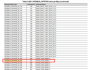

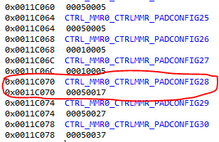

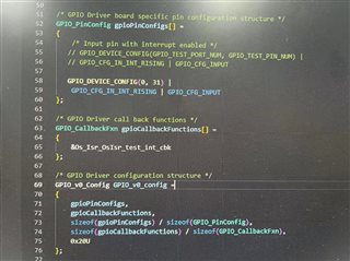

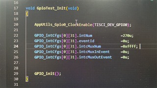

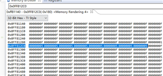

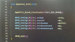

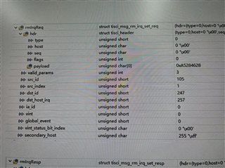

          I had a question on R5F MCU3_0 GPIO input interrupt config,the ball name is AB23, codes and debug information as below:
code:

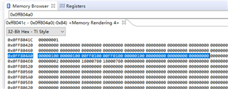

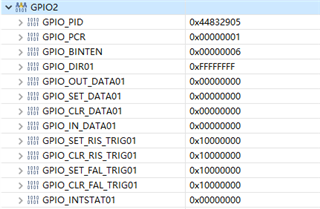

debug result:

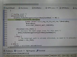

jump to gpio_soc.c

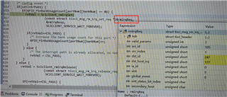

rmIrqReq
and the retVal of Sciclient_rmIrqSet is -1,My configuration of rmIrqReq cannot be wrong.
Are there any other preconditions that are not met?
