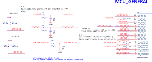

    Refer below regarding I2C slew rate control RC
    AM6442: SK-AM64B purpose of RC filter
    https://e2e.ti.com/support/processors-group/processors/f/processors-forum/1362478/am6442-sk-am64b-purpose-of-rc-filter
    RC filter cutoff frequency is 338KHZ with 4.7K pullup, 62E series resistor and 100pF. and I2C operating frequency is 400KHZ. Thus I2C signal not reach to 3.3V lavel.
    We used 4.7K pullup, 62E series resistor and 10pF. and not observer any concern on VIL & VIH.
    Does TI have any concern with 4.7K pullup, 62E series resistor and 10pF? if not then we are ok to go...
    Below is requested data.
