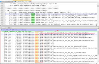

I have 2 problem with this err 'ti-sci 44083000.dmsc: Mbox timedout in resp '.
1. i meet this  issue sometimes  on my board when i do reset test.
   we use 8.04 linux sdk.
   This is full logs on soc print.
   Mbox_timedout_in_resp.log
  Is it emmc problem? How to debug this type issue?
2. it will show this err when power on my board sometimes. and then the board is hang up.
  But it is hard to reproduce.

[    1.491754] ti-sci 44083000.dmsc: Message for 0 is not expected!
[    2.520877] ti-sci 44083000.dmsc: Mbox timedout in resp(caller: ti_sci_cmd_get_clock+0x38/0x48)
[    2.520883] ti-sci 44083000.dmsc: Mbox timedout in resp(caller: ti_sci_cmd_get_device_exclusive+0x18/0x28)
[    2.520890] ti-sci 44083000.dmsc: Mbox send fail -110
[    2.529587] ti-sci 44083000.dmsc: Mbox send fail -110
[    2.550594] sdhci-am654: probe of 4f80000.mmc failed with error -110

  • i meet this  issue sometimes  on my board when i do reset test
    Is this a custom board or TI EVM?
    Also has this error started after 8.4 o4 SDK or it was always coming up?
    - Keerthy
  • Hi Keerthy,
    It is produce on my board, not TI EVM board.
    It is repoduce sometimes, meybe it happen one time when i test 20 times.
    Is there any ways to debug it?
    thanks.
    Can you attach debugger and check if the MCU r5f and M3 cores are active when this error occurs in the U-Boot?
    Keerthy
  • Hi Keerthy,
    how to check M3 core is active or not? This error is in normal step not in u-boot, it occurs after u-boot
    from the log file, you can see it happen when drive is running.
    also it not happen every time.
    thanks
  • Hi Xie,
    I understood that it's a not so frequently occuring issue. If you can attach a debugger to M3 and check after the issues come on board. To see if M3 is still active.
    Keerthy
  • Hi Keerthy,
    what is M3 core? as i known in TDA4 platfrom, it has 2 A72 cores, 6 R5f cores, 3 DSP core.
    Do you mean M3 core is mcu1-0 core?
    thanks
  • No i mean the DMSC m3 core that runs the TIFS binary
  • Hi Keerthy,
    if the  issues come on board, and M3 is not active? How can i modify it?
    what will cause mbox fail?
    Is there any way  to monoter mbox err?
    when mbox fail ,then we reboot board. Is this way feasible?
  • Hi Xie,
    The above error comes from ti_sci_rx_callback. There is an unexpected message.
    Can you share the successful log as well?
    - Keerthy

    As i share in file 'Mbox_timedout_in_resp.log'. This is another type err.
    This is mbox timeout err.

  • Hi Xie,
    What firmware are you using on MCU1_0 on your board? Do you use a firmware delivered from TI SDK, or use your own firmware?
    The TI-SCI message that is failing would have been handled by the SciServer running on your MCU1_0 Device Management firmware. The failure happens when the MCU1_0 has not responded to the TI-SCI request in a timely fashion.
    Please connect the JTAG debugger to the MCU R5F core, and see where the execution is when you see an issue. Check if it has run into exception and has aborted, and stopped responding to all incoming TI-SCI requests.
