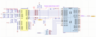

We are booting from eMMC and encountering issues most of the time. Occasionally it boots as expected however, so i'm not sure if we have an instability somewhere.
Here are the hardware connections between Samsung KLM8G1GETF & AM6232 processor.

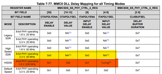

I saw this e2e post referencing some instability with HS200 eMMC mode, which is what is being setup on our board also. Is this relevant to our boot issue at all?
https://e2e.ti.com/support/processors-group/processors/f/processors-forum/1204810/processor-sdk-am62x-am625-emmc-stablity-issue
