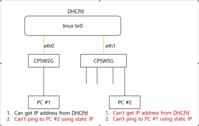

I am inquiring because there is an issue that does not have IP allocation during CPSW5G and CPSW2G bridged.
If they tie the eth1 interface and eth0 interface of CPSW5G to br0, DHCPd works on br0,
PC #1 of CPSW2G is IP allocated, but PC #2 of CPSW5G is not IP allocated.
When PC #1 and PC #2 are set to static IP respectively and ping each other, the ping is not possible.
Please see the use case diagram below.
Please check if DRA821U is able to support this use case on top of the J7200 EVM.
