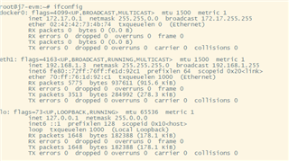

I use port 1 of CPSW9G module to send and receive data.  It Corresponds to the A72 virtual mac Eth1. It works fine.
Can I use vconfig to set up the VLAN for Eth1?
sudo vconfig add eth1 100
sudo ifconfig eth1.100  192.168.1.3 netmask 255.255.255.0 up
Show that I have created it successfully
root@j7-evm:~# ifconfig
docker0: flags=4099<UP,BROADCAST,MULTICAST>  mtu 1500  metric 1
        inet 172.17.0.1  netmask 255.255.0.0  broadcast 172.17.255.255
        ether 02:42:ad:ee:89:dc  txqueuelen 0  (Ethernet)
        RX packets 0  bytes 0 (0.0 B)
        RX errors 0  dropped 0  overruns 0  frame 0
        TX packets 0  bytes 0 (0.0 B)
        TX errors 0  dropped 0 overruns 0  carrier 0  collisions 0
eth1: flags=4163<UP,BROADCAST,RUNNING,MULTICAST>  mtu 1500  metric 1
        inet 127.172.2.2  netmask 255.0.0.0  broadcast 127.255.255.255
        inet6 fe80::72ff:76ff:fe1d:92c1  prefixlen 64  scopeid 0x20<link>
        ether 70:ff:76:1d:92:c1  txqueuelen 1000  (Ethernet)
        RX packets 180  bytes 41861 (40.8 KiB)
        TX packets 67  bytes 10396 (10.1 KiB)
eth1.100: flags=4163<UP,BROADCAST,RUNNING,MULTICAST>  mtu 1500  metric 1
        inet 192.168.1.3  netmask 255.255.255.0  broadcast 192.168.1.255
        TX packets 36  bytes 6706 (6.5 KiB)
But I set the PC's Vlan ID to 100 and  ping to a72 didn't work.
Am I doing this right ?
