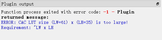

When we use the CAC module, we calculate the LUT Width and LUT Height according to the input Down-sampling. However, when Down-sampling < 36, the software has an error about "LUT size is too large". Is there any way to reduce Down-sampling to allow intput a larger LUT? Since we want to enter a more accurate LUT.
