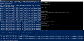

we are trying to setup the Enet Layer 2 CPSW SWITCH Example with the SK-AM64B Evaluation Board.
Empty project can be started and debugged. Enet-Example works also very well.
CPSW SWITCH Example can be started but is stuck after Port 1 link up.
Got the the example from MCU SDK C:\ti\mcu_plus_sdk_am64x_08_05_00_24.
Output from UART Terminal:
 Layer 2 CPSW SWITCH Test
Init all peripheral clocks
Enabling clocks!
Create RX tasks
cpsw-3g: Create RX task
Open all peripherals
cpsw-3g: Open enet
EnetAppUtils_reduceCoreMacAllocation: Reduced Mac Address Allocation for CoreId:1 From 3 To 2
Init all configs
cpsw-3g: init config
Mdio_open: MDIO Manual_Mode enabled
cpsw-3g: Open port 1
EnetPhy_bindDriver: PHY 0: OUI:080028 Model:23 Ver:01 <-> 'dp83867' : OK
cpsw-3g: Open port 2
PHY 0 is alive
PHY 1 is alive
Attach core id 1 on all peripherals
cpsw-3g: Attach core
cpsw-3g: Open DMA
initQs() txFreePktInfoQ initialized with 16 pkts
cpsw-3g: Waiting for link up...
Cpsw_handleLinkUp: Port 1: Link up: 1-Gbps Full-Duplex
MAC Port 1: link up
cpsw-3g: Port 1 link is up
Sysconfig File is out of the example. It seems like second PHY interface is not configured.

  • Hi Ashwani,
    here is the screenshot you asked for.
    Board is SK-AM64B.
    CCS Version is 12.3.0.00005.
    Syscfg Version is 1.14.0
    CPSW-Port is connected to Ethernet-Adapter of my PC (PHY0).
    Second Port is connected to Ethernet-Adapter of the docking station (PHY1).
    Hope that helps.
    Best regards
    Jonas
