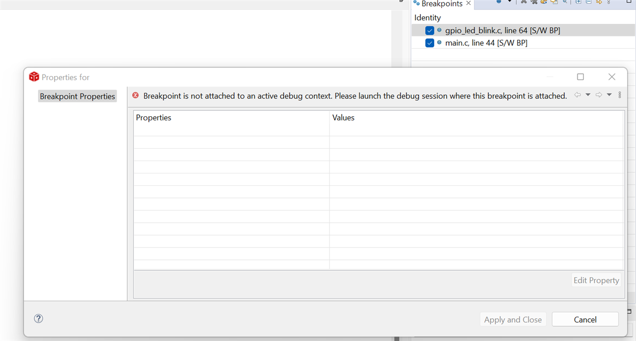

Hello, I have a SK-AM64B board and want to debug a Hello World application in CCS. When starting the debug mode the program stops at the entry point of main(). If I now click on play, the program runs through but does not stop at the set breakpoints. The breakpoints appear blue. In the breakpoints window under Breakpoints Properties I get the following message: "Breakpoint is not attached to an active debug context. Please launch the debug session where this breakpoint is attached."
What can I do to make the breakpoints work?

I have imported in CCS the project "gpio_led_blink_am64x-evm_r5fss0-0_nortos_ti-arm-clang" from the examples. Then I set a breakpoint at the function "gpio_led_blink_main()" in Line 44. When I debug the program, the program execution stops at the start of the main() function in line 40. Now when I click play, the program no longer stops at line 44, even though the breakpoint is reached and the function was called. I can stop the program execution at any time. In the breakpoint window there is also an error message.

Hello, yes I was able to solve the problem.
When I set breakpoints and then started the debug sesion, they did not work. If I removed the breakpoints again during the degug session and added them again, then it worked. I think this is still an incorrect behavior?
You need to being an active debug session before setting a source line breakpoint. Otherwise the debugger does not know what debug session the breakpoint applies to. Hence the error message in your second screenshot. This is expected behavior.
