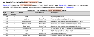

    Understood, but unfortunately, I think this might be a possible silicon errata if the ROM code is setting these registers. As a alternative, I suggest checking the physical port number defined in Table 4-60. OSPI/QSPI/SPI Boot Parameter Table of the TRM (or address 0x41cffd00).
    Here is a quick experiment I did for booting from OSPI vs QSPI and how the register address changes:

    And attached here is the relevant location of the TRM:
    I understand that this is not the ideal, but if customer knows which physical port the QSPI device is connected to, then this could be used to differentiate between OSPI and QSPI.

  • Hi Matsumoto-san,
    Thank you for your patience. I was able to have a meeting with the ROM team to do an in-depth analysis on why QSPI is reporting back 85 instead of 80. We found out that in ROM, QSPI=OSPI=SPI=85 is set intentionally. Current alignment between ROM team and I is that this is a bug in the TRM.
    For the purpose of detecting whether the boot peripheral is OSPI vs QSPI, I got a suggestion from the ROM team to check the "Read Cmd" field in below table.
    For OSPI, this value should be 0x8b, QSPI 0x6b, and SPI 0x3. The main benefit of this method is that this is not board dependent like port number, which was the suggestion I made in my previous post.
