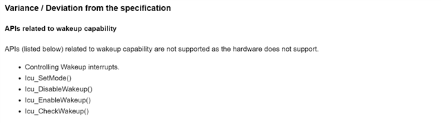

Hello Team,
In  ti-processor-sdk-rtos-j721e-evm-08_05_00 MCAL for ICU driver , we are getting compilation issue for below APIs
Icu_CheckWakeup
Icu_DisableWakeup
Icu_EnableWakeup
Icu_SetMode
Pradeep R
  • Hello Pradeep,
    It is mentioned in Icu User guide document that the mentioned API's has hardware limitation.
    I will raise an Internal ticket for the issue fix.
    Tarun Mukesh
  • Hello Tarun,
    If there is an Hardware Limitation, atleast as per autosar standard, dummy definitions for these functions need to be provided.
    Please let us know the internal ticket.
    Thankyou.
    Pradeep R
  • Pradeep,
    Internal ticket for this issue is MCAL-11611.
    Tarun Mukesh
  • Hello Pradeep,
    You can find the patch attached below for the issue with dummy function.
