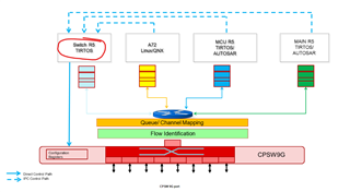

  • Hi Sudher,
    We have some questions to clarify certain functions on CPSW switches:
    1.  What does "TI RTOS Switch" mean in the image below? Is it a separate processor that configures the CPSW9G switch?
    2. Can Autosar (on MAIN or on MCU domain) configure the CPSW9G switch? Or it is only possible with the RTOS?

    One additional question:
    1a) What is the IPC control path in the image from the previous question?
    Marko
    No, It is Main R5F0_0 (MCU2_0) core where Ethernet Firmware is running, has the control over CPSW9G switch.
    All client cores will communicate to Server (EthFw), client core to client core communication is not possible.
    No, Only RTOS on MAIN R5F0_0 can configure.
    Autosar, RTOS, and Linux/QNX (A72) clients also supported, but those can't configure CPSW9G directly. But, can request EthFW (Server) to configure ALE and Policers rules.
    Please refer to Ethernet Firmware User Guide for more details about client cores and more.
