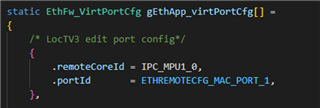

Dear TI experts,
I'd like to post a question about my issue regarding to mapping MAC port.
Currently, I want to create a setup as below:
EVM Board <----> Ubuntu PC
The connection will use ethernet cable.
I've tried the setup in this FAQ
Now I can see that the driver is completed loaded
The ethernet interfaces already presented
Then I start the ethfw by running the vision_apps. I can see that the configuration seems success
Now I able to config the IP Address for interfaces:
But at this stage, I still cannot ping to the Ubuntu machine. I config the Ubuntu machine with address = 192.168.1.201
May I get your consultancies for this issue? What can be the cause and where should I start to check?

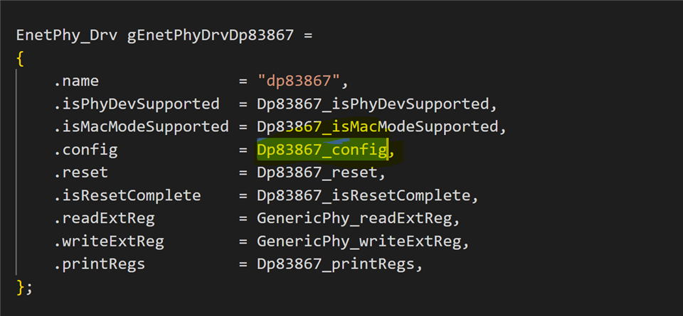

    Can you please share the whole log for analysis.
    Also, can you please confirm is RGMII Tx delayed is enabled at PHY? If so, can you please disable and check once.
    Sudheer

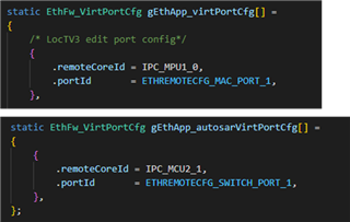

    [MCU2_0]     13.436611 s: EthFw_initRemoteConfig() gEthFwObj.numPorts: 1
    [MCU2_0]     13.436647 s: EthFw_initRemoteConfig() gEthFwObj.ports[i].macPort: 0
    [MCU2_0]     13.436685 s: EthFw_initRemoteConfig() gEthFwObj.numVirtPorts: 1
    [MCU2_0]     13.436720 s: EthFw_initRemoteConfig() gEthFwObj.virtPortCfg[i].remoteCoreId: 0 - gEthFwObj.virtPortCfg[i].portId: 4
    [MCU2_0]     13.436777 s: CpswProxyServer_getMacPortMask: cfg->numMacPorts: 1
    [MCU2_0]     13.436815 s: CpswProxyServer_getMacPortMask: macPort: 0 - hProxyServer->alePortMask: 0x0002
    [MCU2_0]     13.436861 s: CpswProxyServer_getMacPortMask: cfg->numVirtPorts: 1
    [MCU2_0]     13.436897 s: CpswProxyServer_getMacPortMask: macPortvirtPort: 0 - hProxyServer->aleMacOnlyPortMask: 0x0002 - cfg->virtPortCfg[i].portId: 4
    [MCU2_0]     13.436962 s: CpswProxyServer: hProxyServer->aleMacOnlyPortMask: 0x0002 hProxyServer->alePortMask 0x0002
    [MCU2_0]     13.437167 s: CpswProxyServer: Virtual port configuration:
    [MCU2_0]     13.437225 s:   mpu_1_0 <-> MAC port 1: mpu_1_0_ethmac-device-1
    [MCU2_0]     13.438028 s: CpswProxyServer: initialization completed (core: mcu2_0)
    From Logs it seems like MAC Port -1 is mapped.
    As you were using Vision Apps application, you need to change MAC port configuration in "gEthApp_autosarVirtPortCfg" from <PSDK RTOS>/vision_apps/utils/ethfw/src/app_ethfw_freertos.c".
    Can you map the same MAC port in above which is being configured in Linux side and check once.
    Sudheer

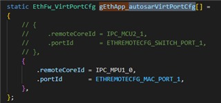

  • Dear Sudheer,
    I've tried your suggestion but there are no effect.
    Here my old setup:
    And new setup
    I also tried to disable the value in gEthApp_virPortCfg, but then, there is no eth0 in Linux side.
    Could you please check this? Am I missing something or do you have any other suggestion?
    Dinh.
  • Hi Dinh,
    From below thread, I assume that you are mapping MAC Port-2 to Linux and same was updated in Linux device tree.
    https://e2e.ti.com/support/processors-group/processors/f/processors-forum/1234660/tda4vm-issue-when-mapped-mac-only-port-to-a72-linux-in-ethernet-firmware
    Above Autosar virtual port configuration not required to change, It is supported on MCU2_1 and that to MAC only Port is not supported. Only Switch port is supported.
    This configuration is fine, for mapping MAC Port-1 to A72 in MAC only Port.
    You need make sure following things.
    1. Port configuration for MAC Port-1, refer below image as reference.
    2. Port enable under gEthAppPorts.
    3. Linux Device tree update.
    Please refer to E2E thread mentioned above where Port-2 is enabled successfully, similarly you have make all relevant changes for MAC Port-1.
    Also, Refer  FAQ  [How to Add MAC only port to A72] for better understanding.
    Sudheer

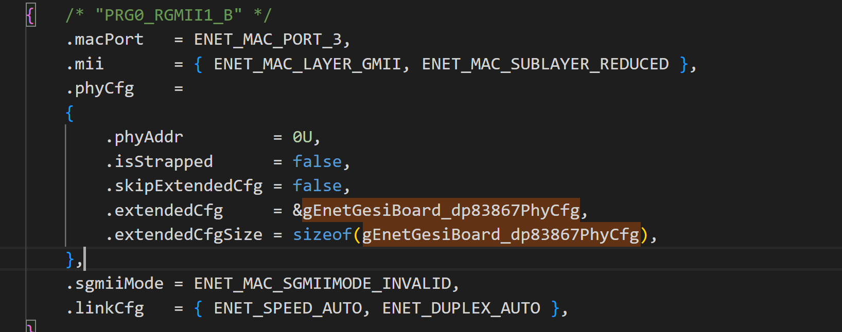

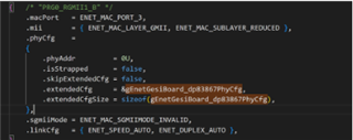

  • Dear ,
    I've checked again my configs. Seems all is fine.
    But I have a concerns about the config #1
    Do I need to to that in cases my custom board using different setup. I'd like to share my setup here:
    Beside that, when I tried capture the packet using tcpdump. I found that it seems the ethfw is able to receive the data but unable to send out data.
    Please refer below: I set the IP of board is 192.168.1.5
    Could you please check and confirm my setup and my observe?
    In cases they all fine. Are there any other items that I can check?
    Thank you
    Dinh.
    It is specific to PHY you are using, not sure whether those are required in your PHY or not.
    Can you please disable RGMII Tx Delay in PHY and check once.

  • Dear
    Could you please help guide me how to check and disable RGMII Tx Delay?
    Can you please confirm, whether these captures from Linux A72?
    If so, who is having 192.168.1.100?
    I capture from Linux A72 side. And 192.168.1.100 is my Ubuntu PC
    For other information, I'll collect and update to you later.
    Loc.

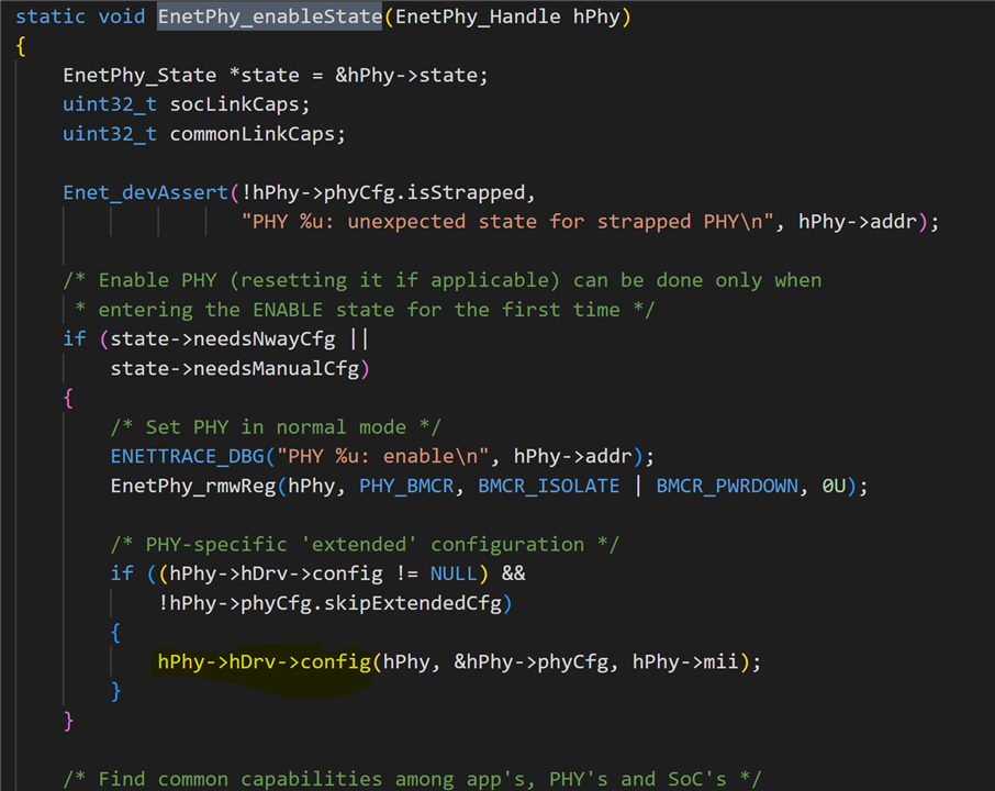

  • Hi Dinh,
    It will be in PHY Spec, we need to access PHY register and update those.
    For reference please refer to below PHY register for RGMII Tx & RX delay control n DP83867 PHY.
    If you can't from PHY side, you can try from CPSW side. But is not recommended to disable.

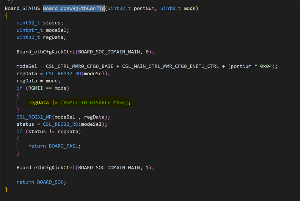

    Comment out below highlighted line.
    Can you open Wireshark in Ubuntu PC and confirm if any packets being received.
    Sudheer
  • Dear ,
    Could you please tell me the logic behind the action comment out: regData |= (RGMII_ID_DISABLE_MASK);
    I not tried the update to PHY regs. But when I comment this line out. The ping command now able to works.
    Dinh.
  • Hi Dinh,
    By default CPSW side RGMII Tx delay is enabled. As Tx is from MAC to PHY so, default enabled in MAC side and not required to enable at PHY side.
    Where as Rx has to be enabled at PHY, MACs may not support for the same.
    As you are not aware of how to disable in PHY side, I suggested to disable at CPSW MAC side. But, Ideal recommendation is disable at PHY side.
    If possible disable from PHY side.
    If Tx delay enabled at MAC side and PHY side then data may corrupt captured at PHY side and will not be sent out to line.
    Good to hear that, your issue got resolved with above change.
    Sudheer
