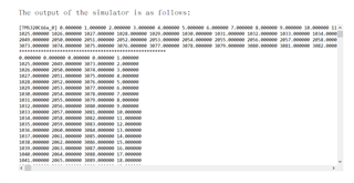

Hi Experts,
A customer has a query regarding the EDMA3 technology for the C6678 processor. We would appreciate it if you can provide feedback regarding the code written and some questions below.
I have attached the image of the code and output as well as the document file for easier reference. Thank you.
Question 1: There are some issues with the simulation data, and the transposed
results are not quite correct. Is it a parameter issue?
Question 2: I am running this code on the C6678 development version and cannot output results. EDMA3 polling has fallen into a dead loop. What is the reason?

    Before we get into your code, I would recommend you to have a look at the following code which does the ping-pong test on C6678 processor device.
    Using the CSL sample code, I have just created a test-app EDMA-code to do the PING-PONG test on C6678.
    I have tested it on C6678 board and the results are geiven as a CCS-snapshot.
    The EDMA test flow is here:
