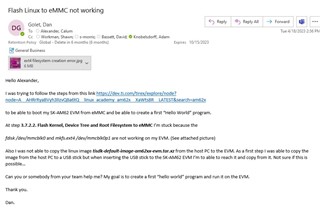

    But, I already tried this and I remember I got stuck at the 3.7.2 Flash Linux to eMMC step. After doing what is described at step 3.7.2.1 Flash U-Boot to e-MMC, I was stuck at 3.7.2.2 when creating that "ext4 partition" in the "user partition"
    - fdisk /dev/mmcblk0
    - mkfs.ext4 /dev/mmcblk0p1
    Also the "Copy the Linux image from the host to the EVM" indication is not very clear... Which image is this referring to? I have the "tisdk-default-image-am62xx-evm.wic.xz". I have tried this some time ago with a USB stick, but the transfer from USB stick to EVM I was not able to do. See here the e-mail sent by me at that time to TI team.

  • Hello Dan,
    To run the Hello World example, you don't need to perform the steps of flashing Linux to eMMC. You already have a Linux running on the board from the SD card mounted on it. So, you can directly follow the Hello World example guide.
    The steps to flash Linux to eMMC are only required if you want to boot Linux from eMMC instead of SD card. It is highly recommended to use SD card for the initial phase of getting started with the board. If at later stage, it is required that the Linux must boot from eMMC then those steps can be followed.
    Prashant

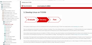

    Thanks for clarifying this. So I will move directly to 3.8 First "Hello World" Program
    Regarding the indication to "source the script" that should "set up the development environment including the toolchain paths on the host"
    I have done this on the Linux PC (development PC with Ubuntu), but I'm not sure what to do next. See below picture
    where should I create that "simple C program to print "Hello world" and where should I place this "hello_world.c" file?
    It's not very clear how to do this, and as I have said I'm not very experienced with Linux development.

  • Hello Dan,
    You can create the C source file anywhere you want. After creating the source file, you just need to run the below build command (also mentioned in the LInux Academy guide) from the directory of the source file.
    ${CC} hello_world.c -o hello_world
    where ${CC} will evaluate to the compiler toolchain which will build the C source file & generate the executable for the target architecture. Afterwards, you can copy the executable onto the board and run the same.
    Prashant
