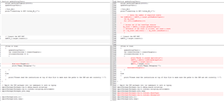

2. I put the board on DEV BOOT mode (my device is HS-FS). In this mode, if I'm programming inside the CCS I have to load the load_dmsc.hs_fs.js through the scripting console.
But I'm not using CCS (because my ultimate goal was to make a batch file to include the execution of this script as well as the Lauterbach script)
where my  load_dmsc.hs_fs.js is modified to first reset the board at the beginning to be able to reprogram it and also, load the application after loading the ccs_init_elf_file (containing SYSFW and boardcfg).
 reference: https://software-dl.ti.com/mcu-plus-sdk/esd/AM64X/latest/exports/docs/api_guide_am64x/HSFS_MIGRATION_GUIDE.html
By doing so, I'm able to see the Hello World printing on my console, and it seems it's successfully programmed.
However, the memory package for your debugger script doesn't mention how the loading program is calculated and it is loaded where.
At this step, if I attach my Lauterbach probe to J25, the debugger is automatically transferred from J28 to J25 (external debugger which is Lauterbach here), meaning that I can not use TI's debugger script anymore to reprogram it. and each time I need to disconnect the Lauterbach probe (so it is switched to the internal debugger), program it, reconnect the probe, define my CPU as R5-0, and attach it. However, this is not pleasant because each time I have to disconnect Lauterbach to load the program with the internal debugger into RAM and then connect the debugger to attach Lauterbach for debugging.
So I tried to implement an equivalent of the load_dmsc.hs_fs.js  in Lauterbach which is setting some values for the defined addresses and loading ccs_init_elf_file and then my application files.
I think it's maybe because it's not loaded at the right address. In your Javascript, I can not see where the ccs_init_elf_file is loaded, however, for a non-HS-FS, the loading address is visible. Based on the linker file, I could see the address of the SRAM that is used which is E:0x70080000. But should I put both of these two files (ccs_init_elf_file, and my application back to back? I tried to put only the first one, but the debug port fails).
Can you help me with how should I modify it to be able to either do everything with Lauterbach(programming and debugging) or to be able to do it with a batch file without changing the connection or do the power cycle manually?

  • Hi Boshra,
    The starting two images are not visible to me. Can you please send it again ?
    Can you please send the equivalent load_dmsc_hsfs.js file created by you?
    For the automation of code execution without using CCS we have an existing FAQ. Please refer Automate code execution.
    Thanks & Regards,
    Tushar
  • I attached it here. But I have also highlighted the differences I made in the picture earlier.
    I tried to do the same as this script with Lauterbach, But  I don't know exactly at what address into RAM I should load the executable ccs_init_elf_file.out and at what address should I load my application_r5.out. I loaded them one after the other or only the first one at E:0x70080000, which seemed its the address used by the linker script. But it doesn't work.
    Note: I could not create the elf file when I choose the compiler to be GNU V7.2.1 in  CCS, it only generates the images and executable, that's why I'm loading the executable instead of the elf.

  • Hi thanks for your reply, the modification I did for load_dmsc seems working (I don't know if it was the right way to do it or not though), and it was not the reason for my ticket, But I will apply your suggestions to make it cleaner.
    My problem is that I want to debug and reprogram it with Lauterbach and as soon as the Luaterbach debugger is connected, the debugger switches from the internal debugger to the external which is Lauterbach. So if the Lauterbach probe is connected to J25 JTAG, the debugger (hw side) switches to J25, and it's not J28 JTAG anymore. Therefore, if Lauterbach is connected, I can not program it the way I explained.
    In the image that I also sent you earlier, I was trying to write a script that is following the same steps as load_dmsc_hsfs.js. Can you explain to me what is it missing and how I should make it work?
    thanks,
    Boshra

  • I modified the Lauterbach script. The loading address was as it was in the linker script at address 0x70080000 of SRAM for R5. Both the SYSFW and application are loaded at this address. However, there should be a wait between loading the SYSFW and then the application. Probably the ROM code copies that to another address and we should wait for it to complete before loading our application. Also, I added a warm reset at the beginning to be able to reprogram it.  So it was resolved by adding a wait between the two loadings.
