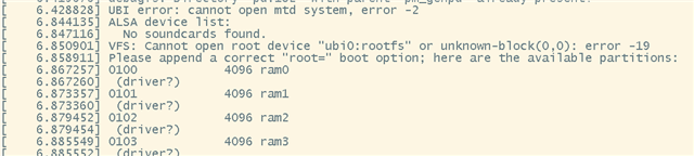

We are testing boot from nor flash on AM62x Customer Board. We burned the Image, dtb, ubifs to flash, configured uboot parameters and linux device tree. But the following error was reported after startup.
I found that when the kernel starts, the flash is not devided according to the specified partition. It has only two partitions(data0 and data1) , and it's not what we want.

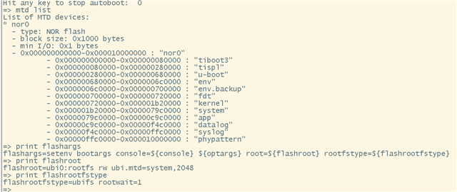

the uboot parameters is likes below
Please help to see if this configuration is ok, and how to mount the ubifs ?

    And how does your 'mtdparts' ENV variable look in U-Boot?
    Regards, Andreas
  • Hi Andreas,
    The SDK is ti-processor-sdk-linux-am62xx-evm-08.06.00.42
    linux-5.10.168+gitAUTOINC+2c23e6c538-g2c23e6c538  u-boot-2021.01+gitAUTOINC+1c0d06c606-g1c0d06c606
    the mtdparts env is "env set mtdparts nor0:512K(tiboot3),2M(tispl),4M(u-boot),256K(env),256K(env.backup),128K(fdt),20M(kernel),0x5ea0000(system),80M(app),43M(datalog),11M(syslog),256K(phypattern)"

  • Thanks for confirming the details. I wonder how the 'data0' and 'data1' partitions are created/where do they come from, instead of the partitions you really want. Can you please also run the following 3 commands and report back the output (output from my board is just for reference-- please ignore).
    # cat /proc/cmdline
    console=ttyS2,115200n8 earlycon=ns16550a,mmio32,0x02800000 mtdparts=fc40000.spi.0:1m(ospi.tiboot3),2m(ospi.tispl),4m(ospi.u-boot),256k(ospi.env),256k(ospi.env.backup),57088k@8m(ospi.rootfs),256k(ospi.phypattern);omap2-nand.0:2m(NAND.tiboot3),2m(NAND.tispl),2m(NAND.tiboot3.backup),4m(NAND.u-boot),256k(NAND.u-boot-env),256k(NAND.u-boot-env.backup),-(NAND.file-system) root=PARTUUID=00000000-02 rw rootfstype=ext4 rootwait
    # zcat /proc/config.gz | grep CONFIG_MTD_CMDLINE_PARTS
    CONFIG_MTD_CMDLINE_PARTS=y
    # cat /proc/mtd
    dev:    size   erasesize  name
    mtd0: 00100000 00040000 "ospi.tiboot3"
    mtd1: 00200000 00040000 "ospi.tispl"
    mtd2: 00400000 00040000 "ospi.u-boot"
    mtd3: 00040000 00040000 "ospi.env"
    mtd4: 00040000 00040000 "ospi.env.backup"
    mtd5: 037c0000 00040000 "ospi.rootfs"
    mtd6: 00040000 00040000 "ospi.phypattern"
    Regards, Andreas
  • Hi Andreas,
    Sorry for the late response. We had a holiday a few days ago.
    After I change the “nor0” in mtdparts to “fc40000.spi.0”, the mtd partition is normal.
    nor0 can only be used for uboot, fc40000.spi.0 is used for linux.
    Stephen
